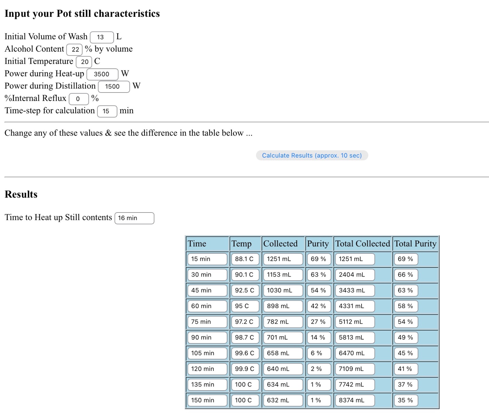

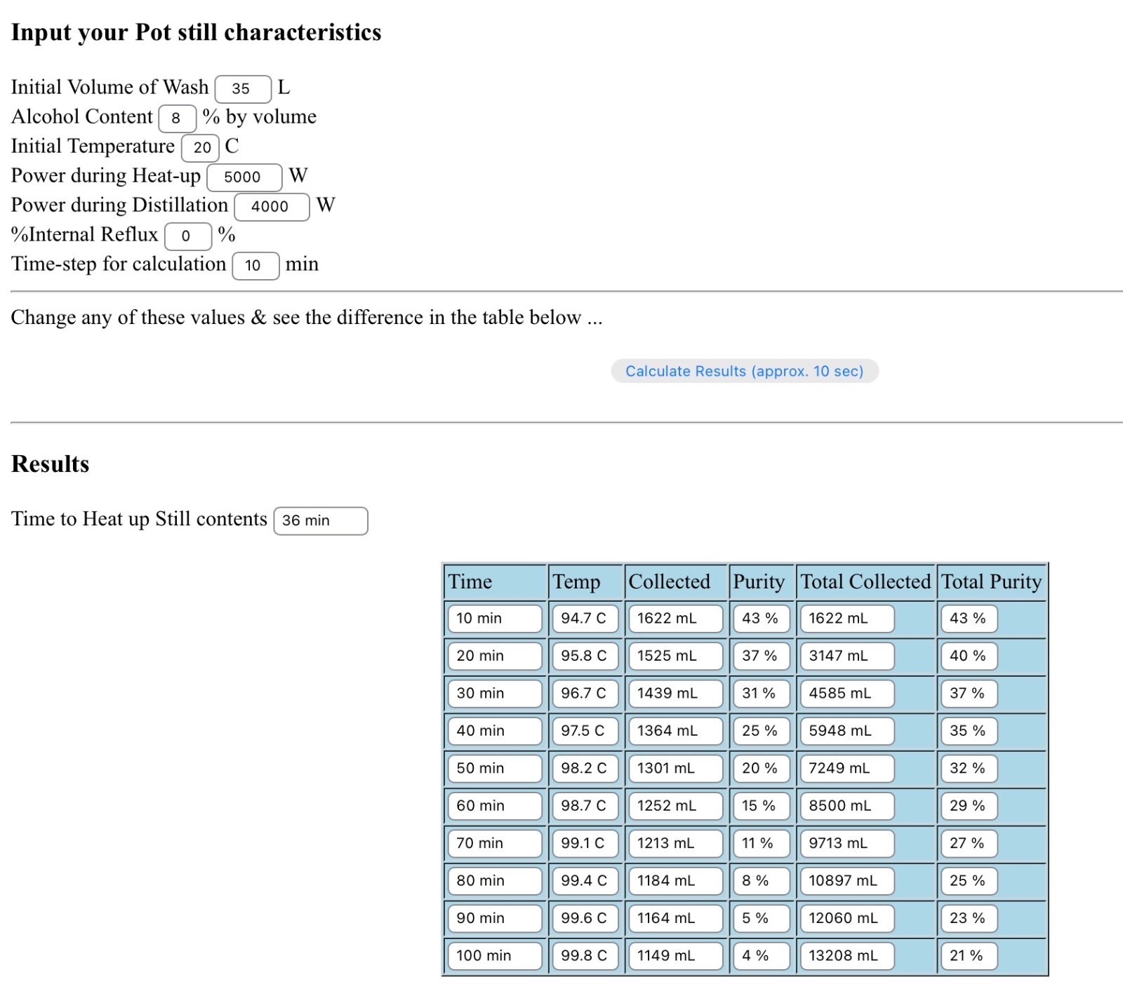

- Posts: 10370
Re: What still to built or buy?
This is the output from the online calculator: https://homedistiller.org/wiki/htm/calc ... t_calc.htmjoschi wrote: ↑Mon Nov 20, 2023 5:51 am i'm finally planning on building a bigger still, my plan is: Pot still with 50 l beer keg, liebig about 1'200 mm long (better 1'400 mm?) 22 mm inner diameter, 28 mm outer tube, 5'500 watt internal heating element with SCR controller. Are my numbers correct?
I think i read here, stripping can be done in 2 hours, is that possible?
How fast can i expect a stripping run, and how long would a spirit run be (just a rough guess)
thank you
I’ve made assumptions for your wash and still operation because of the details not provided. But, the data seems plausible, although that is not the way I’d run your still.
Also, running it this fast would be acceptable for a strip run, but too fast for a spirit run, unless you like to smear everything from the back to the front—>brings an image to mind of someone sitting in an outhouse! (That’s a LOO for you Aussies)
This is an estimate for the spirit run of your low wines.
Notice, I’ve lowered the heat input so you don’t smear quite as bad.

@still stirrin: i knew i cant run that fast for a spirit run, but thanks for the reminder, and also this calculator, saw it before, but somehow i forgot a about it ...
NormandieStill
- Posts: 2308
- Location: Northwest France
The condensor calculator on the site suggests that you want closer to 2m if you want to run your full 5.5kW. I have just under 1m of jacketed 16mm and I can overpower it from around 3.5kW and I have basically no flow control at that point. If you want to get maximal efficiency of your cooling water then you need extra length.joschi wrote: ↑Mon Nov 20, 2023 5:51 am i'm finally planning on building a bigger still, my plan is: Pot still with 50 l beer keg, liebig about 1'200 mm long (better 1'400 mm?) 22 mm inner diameter, 28 mm outer tube, 5'500 watt internal heating element with SCR controller. Are my numbers correct?
6 hours seems to be the sweet spot for spirit runs. Regardless of boiler size. You just need to choose your element to match the volume.

2 meters? Wow, don't know if that fits in my space, have to make some considerations then, but thank you for the advice. I will go as big as possible then. I think it would help with a bigger diameter? If i can find bigger copper-tubes and fittings.NormandieStill wrote: ↑Tue Nov 21, 2023 12:31 amThe condensor calculator on the site suggests that you want closer to 2m if you want to run your full 5.5kW. I have just under 1m of jacketed 16mm and I can overpower it from around 3.5kW and I have basically no flow control at that point. If you want to get maximal efficiency of your cooling water then you need extra length.joschi wrote: ↑Mon Nov 20, 2023 5:51 am i'm finally planning on building a bigger still, my plan is: Pot still with 50 l beer keg, liebig about 1'200 mm long (better 1'400 mm?) 22 mm inner diameter, 28 mm outer tube, 5'500 watt internal heating element with SCR controller. Are my numbers correct?

The link to the calculator is here. Play around with the numbers. Things to take into account are: how cold you are prepared to keep the coolant outlet temp (this directly impacts flow rate, so you'll use a lot more water if you want to keep the output cool), vapour speed (a larger diameter tube will reduce the vapour speed which allows for more contact time with the walls. This is the reason that shotgun condensers are so efficient, for their length, the vapour speed through them is highly reduced as they often present a cross-sectional area almost equal to the lyne arm.
The biggest factor will come down to how big you can actually make your liebig... this depends on the size of the room and your budget. But in general... go as big as you can. I speak from experience when I say that it sucks to butt up against the limits of what your condenser can handle.
