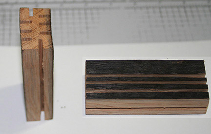

A question for the group. I am using toasted used bourbon barrel chunks that were made for smoking. https://www.amazon.com/CharcoalStore-Bo ... ood+chunks. I toasted them and propane charred them all the way around. My question is, how many of these do you guys think I should put in a half gallon jar? I have 2 per jar right now, but the surface area of the chunks is not very much. Chunks are about 2x2x1.

Yours are probably half the size of mine and these were based on T's original pieces....so...two of yours?...Kiwi

Gish wrote:A question for the group. I am using toasted used bourbon barrel chunks that were made for smoking. https://www.amazon.com/CharcoalStore-Bo ... ood+chunks. I toasted them and propane charred them all the way around. My question is, how many of these do you guys think I should put in a half gallon jar? I have 2 per jar right now, but the surface area of the chunks is not very much. Chunks are about 2x2x1.
I picked these up about a month ago as well. Since they're only toasted on one side I was planning on sanding the char down, splitting them into about 1" sticks and roasting them, much like yourself. I will follow this with the blowtorch char. This way all the sides are charred.
My pieces are averaging about 3 inches long so roughly 14cm2 of surface are (1X1X3 calculation). I will put 5-6 per gallon for an average of around 22cm2/liter
Your 2x2x1 inches gives about 16cm2.(http://www.calculatorsoup.com/calculato ... cearea.php" onclick="window.open(this.href);return false;" rel="nofollow). 3.8 liters per gallon so 1.9 liters total for 1/2 gallon...22 x 1.9 about 42cm2. 42/16= 2.6. See how 2 sticks does and then you have room for another possibly.
