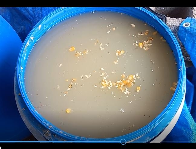

subbrew wrote: Mon May 16, 2022 6:31 pm Running that soon after fermentation completes you run the risk of scorching some yeast.
I strip mine as soon as it's dead, no cooling, no clearing, open the spigot and filter it through it's own grain bed, putting the first out back into the top of the fermenter. I've never seen any sign of scorching of anything.
Posts: 10582
NZChris wrote: Mon May 16, 2022 10:30 pm open the spigot and filter it through it's own grain bed
That wont happen with mine, don't you grind your grain or something ? That stuff sets hard on the bottom after a few gens even if you stir it up every time. Only way mine comes out is with a siphon hose or some sort of dipper.
Having said that Ive never had one scorch, and Ive run it fresh , 6 months old and every thing in between.
Running Rum wash out of the spigot works for me , just toss that first yeasty quart.
NZChris
Posts: 13949
Location: New Zealand
Post by NZChris »
Sometimes it takes longer than others, depends on the crack I suppose. After a first generation, (which uses frozen backset from the previous series), I seldom do single run worth of wash. The first strip worth is never up to distilling temperature before the second strip is drained and in the preheater, the last strip worth has plenty of time to filter through it's grain bed before it has to go into the preheater.
The backset from the first strip is enough for the next generation, which is usually bubbling before the still gets shut down after the third strip.

Question... because i'm starting to think that this thing is ready to run even though it looks different this time around...
Will a finished UJSM "ALWAYS" look clear? The previous generations always ended up clear once it was done fermenting... as in like I open the lid to my 'blue' food grade barrels and what was a white cloudy color at first turned into just a dark color inside the dark blue barrel...meaning it was basically 'clear' but the dark blue colored food barrels make it look almost black.
Is it possible that if the previous time i used... lets say spring water, and the next time i used a different water, is it possible that it could be done fermenting but not be 'clear' like it normally is?
Or is it still trying to finish fermenting if it still has a cloudy look?
This first one is going on like 2 weeks... a week longer than it has previously taken to ferment... and it tastes bitter. It tastes the way it is supposed to taste. It doesn't taste bad, it doesn't taste too sweet... it has that finished bitter taste, but its not 'clear' this time.
Maybe i'm just being impatient because i want to run another round of shine... but it is very odd to me that it looks/seems different this time.
I can't think of Anything that we did this time around that was different than the previous times... and yes the weather has changed some... but not in a way that is significant in my opinion. it went from mid 90's the previous generation of fermenting to high 80's... that is not a 'massive' temperature change.
I'm going to see if I can upload a short video clip or picture of it.
Is there a way I can tell if it can be run? Can i put it in my hydrometer tube and verify it has alcohol content? and if so, what would that be naturally based on this recipe? somewhere around 5-6% ABV?
Shine_Dad
Posts: 87
Joined: Mon Mar 28, 2022 10:47 am
Post by Shine_Dad »
Here is a video of Barrel 1 - It is going on like 13 days... after adding the 1 tbsp of additional yeast, it didn't change anything, it didn't cause a new head to form or anything... which is why i think its done, i'm just not used to it getting cloudy.
It tastes Clearly more bitter than the barrel next to it that still has a little bit of head and is much more active as far as air bubbles... barrel 2 is the one we decided to recyle 2 gallons of backset so i'm not surprised that it is still working off... but barrel 1... maybe its my impatience but i think its ready to run... I would love some feedback... i'll be busy the next couple hours but if no feedback by then we're going to charge everything and run it and see what happens.
Thanks!
Update: It's not letting me upload a video so here is a picture:
You can see I paused the video in a spot where you can see two bubbles... but it is not just sitting there 'bubbling' / 'working away' like barrel 2 still shows signs of.

Well without input we decided that we really only had one option.
Fuck it. Run it.
We went ahead and ran that barrel tonight. It produced a lower yield as far as total jars, and it was slightly lower in proof than normal and jumped down pretty quick.
We were able to pull out some shit worth keeping for sure, but more importantly ... I ( Think ) we realized what happened.
I got Lazy.
We realized on that barrel that had been going for 2 weeks was one in which I had decided considering it was super hot out, we didn't need to warm up the water and gallon of backset to mix in all the sugar. Previously, I had Always ran the bit kettle pot on the burner to get the water up to 150-160 to mix in the sugar so it dissolved...
We are thinking that because I didn't think it was necessary to dissolve the sugar better, that the yeast was fighting super hard to break it down..
And that basically... that barrel Still wasn't done fully fermenting even after 13-14 days.
But its gone now. We warmed up 4 gallons of water including our 1 gallon of backset ( instead of doing 2 ) to aroudn 150-160 to dissolve all the sugar and have started the fermentation process over on that barrel. We think, or at least have an opinion, that this may have been part of why we had issues. I guess we'll know in a few days.
Moral of the story... I fucked around with things and found out the hard way that I should have just maintained what I had been doing for the first 6-7 generations in these barrels...and i'm reversing those 'experiments' and going back to what I was doing before.
It's okay to experiment with things to see what does what, but also, trust these 'proven recipes'. I'm quite convinced that this new barrel will ferment as normal and have me back to where I was.
