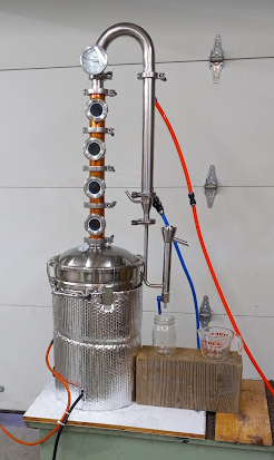

I keep reading. And reading. And reading. But still need clarification...
My questions are regarding distillation. Some folks use a pot still. Quick hard strip run(s) followed by less quick spirit run. Some folks use a plated still and do a one n done. My goal is to make the UJSSM that everyone here raves about. Smooth. Flavorful. Yummy. Here is my still:
I can remove plates and run as pot still (as shown), or put them in along with dephlag and do a reflux one n done. First question: Which is preferable?
My current experiment is gen1,2,3 stripped, then low wines run without plates or reflux (pot still, 25%ABV, 20L charge) low and slow (2L/h). I finished this spirit run as described yesterday, but my thought is that I ran it TOO slow and left a lot of flavor in the pot. Should this spirit run be done slow like I did? Or faster to keep flavors and/or just get the job done?
My gen 4 will be 60L, so I will have 2 or 3 still charges & spirit runs. My plan is to try one n done (3 or 4 plates with reflux). Should I stack the column at the start of the run? Should I try to keep all plates bubbling and boiling throughout the run? Should I do slow product rate (1L/hr). Again, my concern is inadvertently stripping off flavors.
For the first time, I am NOT trying to make a neutral spirit.

Hey PoolGuy, you're asking some good questions here and you've got a rig that will let you do all of the above and more. One question back to you though, what do you plan to do with your UJSSM?
Aging with wood will allow you looser cuts and let you preserve a larger yield. Working in pot still mode with a strip and spirit run will give you more overlap or bleeding of your heads and tails into the hearts and likely give you the most flavor, but it takes experience to know what will taste good after a year on wood.
If drinking white you will be sacrificing some flavors (that aren't great white but might change and/or add complexity if aged) by making tighter cuts, keeping less product near the middle of the run. It's still achievable with a pot still but plates will likely let you get smaller heads/tails and a bigger hearts cut. A side benefit to running plates is it will make your heads and tails cuts more obvious, very helpful as you gain experience.
You can cut for white drinking or aging with either method. You can also make multiple blends from your cuts, mixing in a little broader cuts for aging but keeping a couple jars of the center for drinking white.
I've run UJSSM in all sorts of ways, including a true one-and-done through two or three plates, one-and-a-half runs (most of a charge of mash+low wines from a stripping run) and a standard strip and spirit. For drinking white my preference was through plates, for aging pot still was nice. YMMV.
The one thing I wouldn't bother with if I had 2 or 3 still charges is doing them all one-and-done. If you strip you can do it fast-and-furious and three strips will probably get you a boiler charge that you can do low-and-slow once, rather than having to do three low-and-slow spirit runs.
Give it all a try though! And keep the mash going so you can experiment even more.
Side note, your column is getting tall and could probably use some supplemental support. Otherwise you may find it leans some, which isn't ideal, and you're probably stressing the lid. Maybe you can run a support from your ceiling?
Good luck, and stay safe!

Poolguy, my UJ off a 4 inch 4 plate is very smooth.
3 plates has a bit more flavour.
Personally I run 4 plates mostly.
I initially ran a 1.5 on 4 plates and cut very tight.
Now I run a wash with fients from the previous spirit run, I shut the deflagameter at the end of the run and collect deep.
White, it is good. As Twosheds pointed out you can make a couple of blends.
In terms of how your plater should run, it should run as it should run. Plates loaded and not flooding, just balance power, abv and take off rate.
My plates look the same on a all grain, a UJ or rum. Likewise my take-off rate and abv are the same for all three
