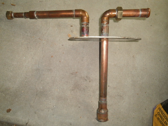

I use always diffuser on my thumpers Is it more effective? I like to think so it seems to make the heat up a bit faster on my set up ,and in my thoughts it causes the incoming vapors to condense more quickly and evenly , The diffuser you were looking at was on my small 8 gallon set up . The 3/4 inch tube just slips in and goes to the 3/4 by 1-1/4 adaptor with the top being drilled with 1/8 inch holes . Since it sits just off the bottom if there is a puke it will not plug up the smaller holes On a difuser with a sealed end such as one coming off of a 90 degree bend I use 1/4 inch holes just for safeties sake. I have never had one plug but it doesn't mean it could not happen as I have never run a cleared mash that could puke 1/4 inch chunks. Again just my thoughts. Here is a photo of the difuser you were talking about.Playhard wrote:Fresh question. I have seen one post by corene1 (11.2.13) who talked about a thumper diffuser using a 3/4 x 1-1/4" reducer with many small holes drilled. Can anyone share a winning diffuser they use. Can you have too many small holes. What's a small hole? 1/16", 1/8" diameter? Or, I have seen 1 post where a v-notch was recommended. Does anyone use a v-notch at the bottom. Is only one notch necessary. Seems like a notch acts like a weir. If one notch is good, are two notches better?
Re: Thumper?

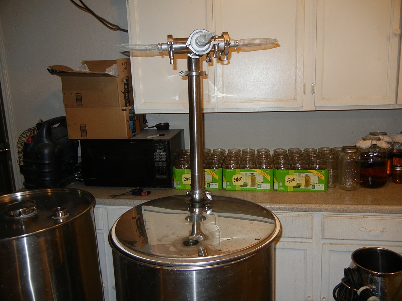

I prefer diffusers as well. Here is a picture of two of my mash tun / fermenter/ thumpers (MFT), as I was assembling one of them for thumper mode. You can see how the diffuser works. I have a dedicated 30G stripping boiler to go with them. I move the clear beer to the stripping boiler and leave the slop in the MFT. The input is 2". Overkill, perhaps, but it works for me. On the lower right is my 15G spirit boiler. Makes a reasonable drop, if I do say myself.
Last edited by RedwoodHillBilly on Sun Dec 24, 2017 1:08 pm, edited 2 times in total.

A little confused with the term here. The pic is of a bad, as in terrible gin basket (infuser), on the outlet pipe, the long pipe on the bottom of the inlet pipe is lined with holes on top, is that a (diffuser)? Seems like it, just never heard the term used before.
Re: Thumper?
Yes you are confused. Perhaps you need to understand what a thumper is and how it works.sltm1 wrote:A little confused with the term here. The pic is of a bad, as in terrible gin basket (infuser), on the outlet pipe, the long pipe on the bottom of the inlet pipe is lined with holes on top, is that a (diffuser)? Seems like it, just never heard the term used before.

Thanks for the "no-info", been using this thumper for over 4 years now with excellent results and no problems, just wanted a definition on a word. How about you answer me that.......without the sarcasm?
Re: Thumper?
If you don't have a clue how these systems work, I guess that you are a troll.sltm1 wrote:Thanks for the "no-info", been using this thumper for over 4 years now with excellent results and no problems, just wanted a definition on a word. How about you answer me that.......without the sarcasm?

i believe the thumper diffuser is show in the picture is attached to the lid and flipped upside down

HDNB, thanx.
RedwoodHillbilly.....have nice day
Re: Thumper?
Of course, I thought that it was obvious to anybody that has done some research, my mistake.HDNB wrote:ahem.![]()
