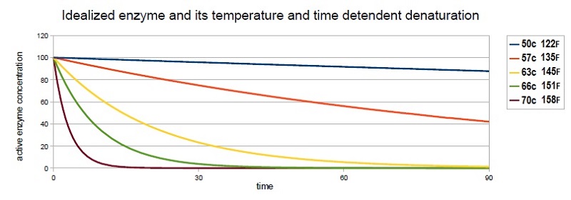

I've got my first batch of this underway as I type. I've been following the recipe as written. It is sitting at 144f with all the malt added. I'll go unwrap it in an hour to allow me to pitch before going to bed. I'll be using us05 dry yeast. I took an sg reading which shows 1040 after temperature correction.
Happy New Years everyone.

Re: Honey Bear Bourbon
Until someone more qualified pops in, my chart says wait 90 minutes.
My apologies if my new greeny arse is wrong on this. (Been celebrating New Year's)
I added the malt about three hours before I reported that temperature. I just went and removed the blankets. It was at 138f. So it's been about 4 hours. I don't have any iodine, so I can't do a conversion test, but I'm hoping 5 hours will be long enough.
Cheers
