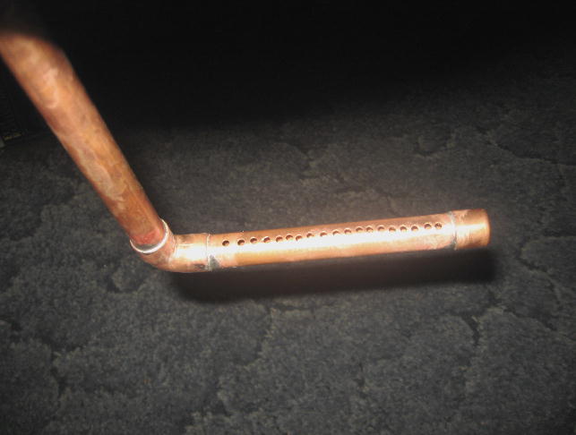

It is, and I will, as I hope you all do too...my 1st Traeger smoked duck is coming of the grill right now and I'm gonna drool on the keyboard if I don't go attend to it. MERRY CHRISTMAS TO ALL>>>>AND TO ALL A GOOD NIGHT!
PS, here's the pic I forgot to load in my 1st query (it's in my thumper)
