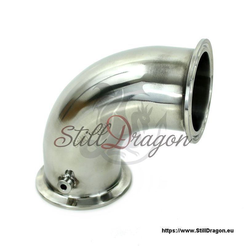

I already have a CM still. What I'm thinking of building is something like this:

Well, in that case, I'm sorry to tell you it won't work.
What you're proposing is a VM still without a valve.
This design will have a whole lot of reflux going on in the column and at the same time vapor is going to the takeoff. You won't be able to control any of it.
Essentially that would just be a long pot still with a dephlegmator on top, which by the way is totally useless in this configuration.
There will be almost no rectification of the spirit and it will be of poor quality. Furthermore, it will smear the fractions all over the place.

@cdd check out the pics of my still from the links on my .signature. You'll see that I use the parts you've shown for my pot still. I also use those same components in my CCVM still. That is the beauty of a modular system!

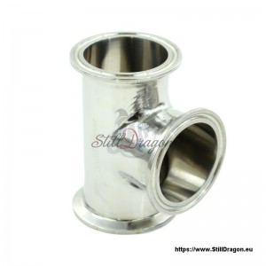

This is my version of your advicekimbodious wrote:@cdd check out the pics of my still from the links on my .signature. You'll see that I use the parts you've shown for my pot still. I also use those same components in my CCVM still. That is the beauty of a modular system!

Looks good..!
However, in this configuration, you'll have to think about a coil for reflux.
A dephlegmator on top won't do the job, as you'll end up with a potstill with some reflux going on once again.
If you put it beneath the tee, you'll end up with a CM still.
Here's how I made a couple of coils: viewtopic.php?f=87&t=52290
Now, there are other ways to fabricate a coil and I don't claim my way is the only correct way but it worked for me.
