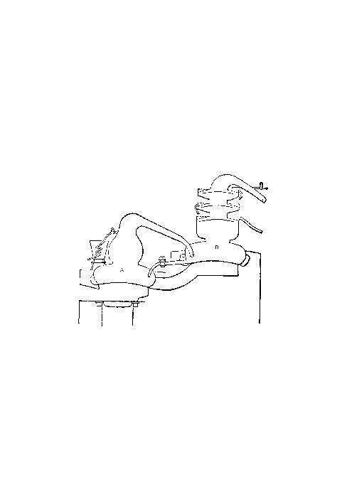

I went back looking for the old still post tha pictured the pistorious still but i could not find it, altho not the same, it is very similar to what has been taked about here.
you will notice the concave plates at the top of the doubler water is poured over the outside top of the plates to lower the temp to generate reflux
i have adapted this idea into the last two designes but i used the returning reflux to control plate temperature.
this is a link to harrys tastylime library where there is some good reading on distillig.

That looks a bit like LWTCS's dog dish adaption with cooling dishes on the column.
BTW welcome back Decoy, I haven't noticed you posting for a long time.

olddog wrote:That looks a bit like LWTCS's dog dish adaption with cooling dishes on the column.
Kinda tough to see that diagram.
Am I seeing 2 cooling dishes?

If you save the diagram, and then enlarge it it's easier to see, yes it looks like two dishes, must have two dogs :mrgreen:

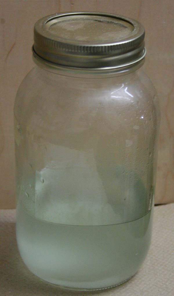

Now, here's something to mull-over!
I ran a 5 gallon rum wash today. Ran the whole thing at 750 watts, and I ran the whole deal with the old BOK takeoff valve open. It ran pretty fast at first, with the first drips at the old BOK takeoff coming at around 161°F, and I collected from there for nearly 5 minutes before seeing the first drip at the product end(the liebig). I kept the valve open and saw a steady drip all the way through, never slowing to under a drip per second or two. But take a look at what the jar looks like! At about the halfway point in the run I knew I had something real here. The picture doesn't show how opaque it really is, as I had to use a flash in my dark shed. There are no floaties like we see in the tails if we push too hard, but instead, it is one nasty looking jar of crap! And this was BEFORE I reached the tails of the run! This was all collected during the foreshots and hearts. When I got to the tails, there was so little left I just shut the old BOK valve and let 'er go at 4500 watts to get the last bit from the wash.
Now, read what I wrote one more time. This was all collected in the foreshots and heart run. The stuff that dripped out in the fores was clear. Very clear. That leaves all the blue/green crap as having come through in the hearts portion. Had I not collected these separately, they would have HAD to go to the liebig along with the hearts. Especially so with a short lyne arm pot still.
I don't think I'll ever run mine as a simple pot still ever again....
Oh, and here's the bonus. I got 2 quarts of hearts in this run! 2 quarts of good stuff(and averaged at 71%ABV) from a single run, 5 gallon wash. No wasted energy with refluxing, a second distill, nothing. And still, I got the full flavor profile. I never got this much hearts when I was keeping the old BOK valve closed, and no way was one run going to give me 2 quarts of clean hearts with my pot still setup in even 2 runs.
Oldog, tap off the return, and get this crap out of your still; no need to re-distill something this bad! I'll check its ABV tomorrow, but I'm sure it's way too low to bother keeping.

Does it look that color in another jar...??? I have two jars that you can't notice the blue tint in until they have high ABV alcohol in them... Even water looks clear... When I dump the spirits into another jar they are clear... Go figure...
Not saying that that's definitely the problem... Had you made a recipe change for this batch...???

The jar's clear; I reuse the same collection jars all the time(wash between uses). Same recipe as always, a few generations old. This is that slick, oily-feeling stuff I mentioned a few times; I would open the BOK takeoff valve and collect a sample from that plate every now and then, it was always oily and slick. This time, I left the valve open and placed a jar to collect throughout the run, just to see, and to say I am surprised by how nasty it is is an understatement. But the most surprising(and best part) is how clean the product was, and how much of it I was able to collect! By keeping this crap out of the liebig, I got a lot more hearts. Now the question is, how much more of this crap is still gettin' through.
Next run, I'll separate the plate collection after the foreshots have run through; right now, when I smell this jar, the fores are what I sniff out most, but the whole of it doesn't smell nasty, considering its appearance.
This isn't a "problem", it shows what everyone's been drinking all along.

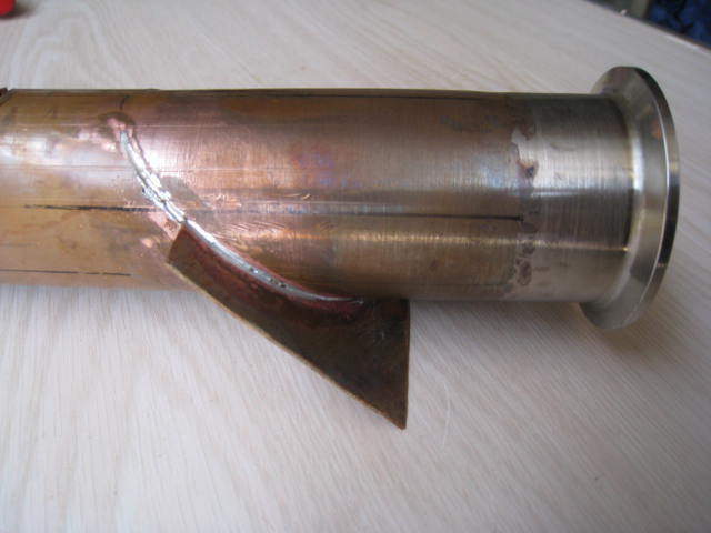

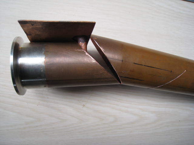

Howdy Barney F, I have been wondering whether the compression of the heads/tails with plate/slant plate colums would give a greater hearts volume as one would assume they should. you answered the question, well done this is inspirational stuff!
I have a question in regards to your Bok take off, have you installed any plates higher in the column than the bok plates or is the Bok take of the top of the stack so to speak?
I have just put together my own slant plate version, 6 plates, each with it's own internal overflow tube feeding the next lower plate with the overflow going directly through the rising vapour. this is a simple build, not much more involved than installing a "standard" plate in a column. will get to give it a run or three next week. But now I'm keen, after your report, on installing some 1/4" take offs as per Bok on a plate or two, think i'll run it first then start playing.
Some pics below of my build to date, not pretty but hopefully functional :D
Silver braze the overflow to your slant plate so it does not come loose when soft soldering into your column
Cut the slot for the slant plate almost through the column, bend it open to fit plate.
Clamp column with plate in correct place and solder
Top view of top plate with overflow.
The assembled column, plates can be trimmed flush but how do the fins affect reflux ??
MM.

Post by HookLine »
Definitely want to try it with the fins first.
Looking good. 8)

I'd leave the fins, too. Try it as-is, then try it with a fan gently blowing on the column, then trying it with an insulated column, and you can answer for all of us what happens with each version. Even without fins, I can gain well over 5% ABV by having a fan blowing on the column.
Yes, my "BOK takeoff" is the uppermost plate; this way, everything above it is still untouched, and I can still add my condenser coil and use it as a reflux head by pulling out the packing that now resides in that portion. I also have my old pot column over this section, so there's quite a bit of column above the BOK takeoff. I'll measure it later for ya.
You have some seriously clean soldering chops, my friend! Between you and Oldog, I'm ashamed of posting any more pics ;) What did you use to make your plates?
MashMan
Re: Simple, yet effective 2" plate column
Post by MashMan »
Barney Fife wrote: You have some seriously clean soldering chops, my friend! Between you and Oldog, I'm ashamed of posting any more pics ;) What did you use to make your plates?
The plates were made from some 2" scrap tube, 80mm long, open up, bash flat, cut in half and you have two plates. try not to sample too much "product" when making these, that way you will drill the holes for the drains in the right edge of the plates first go :oops:
Will give some performance updates as it happens.

I forgot to report back on the ABV of that junk; it came-in at 34%. The jar's contents hasn't settled out at all yet, and being left open, the jar itself now smells rather pleasant, though the fores and heads are definitely present, but unlike a fores-only jar, there's also plenty of good molasses flavor/smell along with the chemical-like smell of the heads and fores. I'm thinking the heads and tails that would be present ion small quantities with the hearts were being stripped effectively, and the combination of these is what gives the jar its coloring.
Another rum run soon, followed shortly by a rye(UJSM style)! We'll see if this one was a fluke or not.

barney aint ever seen heads add color but backins sure will. try putin it in the ice box an freeze to see if it gonna settle.

Good idea on freezing it to see if it'll settle; I'll do that right now. Yeah, there was no color to the fores and early heads, but it's all in the same jar right now; I'll switch jars on the ext run and see what happens.

Well gents i have just spent a day and half doing some runs and making some changes to the plate column with internal drain tubes. as soon as i'm finished here i'm calling in the scrap metal merchant :twisted:
an initial cleaning run with some feints watered to about 30%abv had me thinking I was onto a good thing, the heads started at 80% using 1800w element turned down a bit with my controller, then I realised this is about the same as any other spirit run with my usual short column of 200mm, I quickly changed columns in the middle of the run which took about 30 seconds as everything is plug and play, there was only 2% less abv with the short column wtf ??? disheartened I started thinking that maybe it would produce higher abv from a low abv wash than the short column, yeh thats where the difference will really show up. nope no different. I ran an all grain with an 8% potential fores started about 64% hearts started about 54% and tails at about 40% the product is good fairly certain there is less smearing between heads hearts tails and easier to pick. when swapping colums in the middle of a run I quickly inverted the plate column and poured out what the plates held, water less than 10%abv and only a slight smell of what reminded me of tails, clear and not oily like barney found. so the plates are stripping out the water so why am I not seeing higher abv at the fun end of this contraption?
I slept on this, well tried to and all I could come up with was there must be something wrong with how the plates were draining (or not draining) so I decided to add external drains from each plate per side to a common down tube per side going back to the boiler through the bottom of the column with a water trap to stop vapours rising up these. used 1/2" tube and did a quick rough job so I could test this asap, used the same wash with everything collected back in the boiler. The only difference this mod made was the output now surges and splutters a bit everything else the same :esad:
This column is approx 600mm long, the plates are spaced 3 1/4" apart, are at a 45deg angle and they block about 2/3rds of the column.
If anyone has an opinion on this build and why it's not giving a higher % output than straight open pipe I'd love to hear it.
Cheers,
MM
