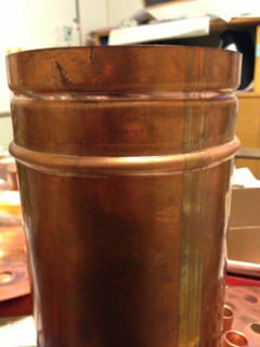

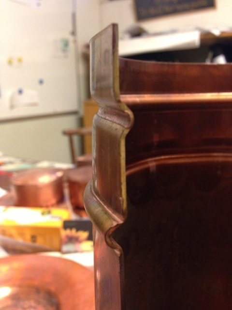

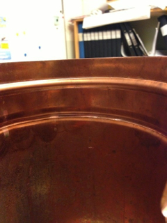

I use a folding machine and the tracks of these pictures are from my little manual fals maskin/folding machine, but on my 100cmx20cm and 100cm x30cm columns are made with one similar to the one in the picture and motorized.
Now there are 3pc different types of 100x200cm 1.5mm copper sheet here in sweden Hard, soft and annealed to buy in Sweden and so far I have been using the soft but that visible on my last picture is made from annealed copper sheet and I will only buy that type ahead for it is much easier to process ...
But my Folding machine is made in Sweden and Note China like this in the picture so 2mm copper sheet is No problem for that…
Cheers from Sweden
