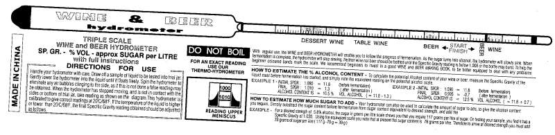

Regarding the meniscus, here is the instruction sheet for my hydrometer. The alcoholometer does not specify where to read the meniscus.
