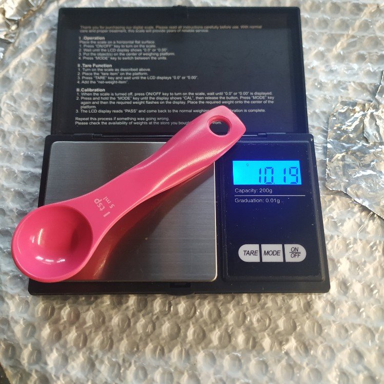

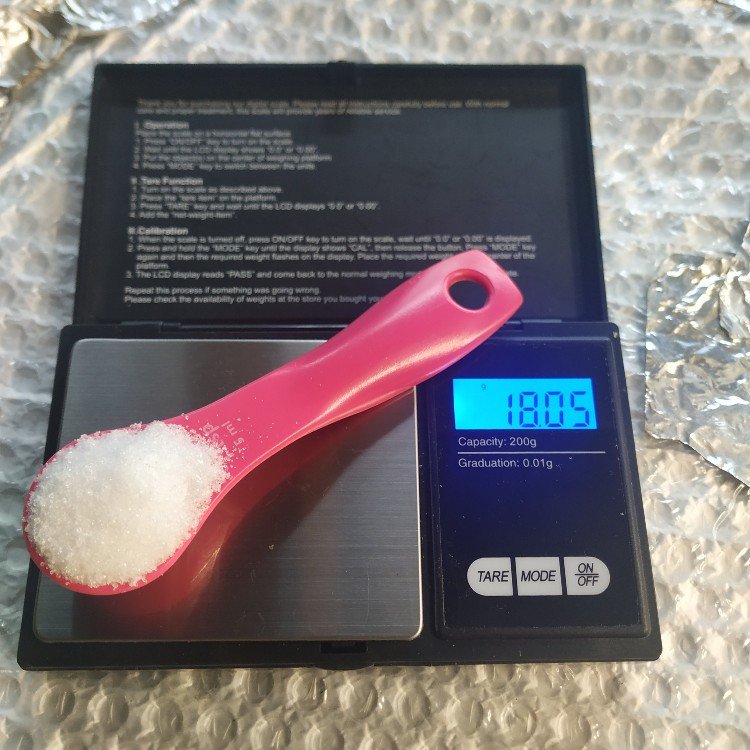

Sometimes I get annoyed with the whole cup and spoon size thing.
In the UK a teaspoon is 5ml (that's what my measure say) or so I thought. But Google informs me that is it is fact 5.91939 that's almost 20% difference. Now I'm never that accurate when measuring DAP. I used about 1 spoon(the spoons I use are definitely not 5 or 5.919ml) per 10l or so.
I took a couple of picture of how much my dap weighs for one of my measuring teaspoon
So i can get nearly twice as much in with a little heapage.
Cheers SomethingObscure
Edited to add pictures

I should probably add I didn't tare the scales after weighing the spoon. So the second and third pictures are the weight of the spoon and dap.
I do 2x 50l batches and don't worry about weight much. With dap you can always add more later. I think less is better if you want neutral. Epsom salts I guess it depends on the water you use.Cristof wrote:Thanks SomethingObscure.
