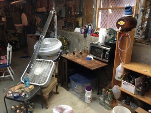

I've finally got enough after last weekend's stripping run to do a real spirit run, I'll definitely try that. Maybe even a whole stick. I still need to dig up the fats thread.jb-texshine wrote:I think there is a topic here somewhere called ,or about fat washing....i think. Read thru it a while back.
For what its worth I use a half stick of real butter in my boiler wher I make rum because it gives a slight butter taste versus veg oil.
I've got a major project due at work this Friday, so unfortunately I can't get any runs in this weekend, I'll be spending the whole time with headphones on staring at my laptop, writing code.
In the meantime, though, my new SCR came in. It's a 2-wire model, instead of the 4-wire that everyone else has been using:
I also finally picked up a plastic project box @ HomeDepot for it, and I have a couple of CPU fans to use, one to blow in and over the heatsink, the other to blow out the other side. I think I'm going to wire it up for 110 for a bit, and get a good, slow spirit run done before I try it at 220 again for more stripping runs. The slow heat-up is the only drawback, but I'll just charge the keg and get set up the night before (with the PTFE gasket that just arrived), then just plug in as soon as I get up next Saturday morning so those almost 3 hours will go by early.
In other news, I picked up a $25 microwave on Craigslist on the way home from work last night. We haven't had one in the house for over 10 years now, and this one is going straight to the basement for aging experiments. I've got a few jars in mind for it already.
Research-wise, I've learned that I've been making my cuts too tight in the interest of having something to drink sooner. I really need to start making wider cuts and being more patient. I also think I'm going to order a bag of cherry wood smoking chips to try out, instead of the JD chips I'm using now. I don't have a problem with the JD chips, they're working well for me, I'd just like to try cherry. I'm also hunting for some white birch, it's one of my favorite flavors.
Oh, and I also am going to try a few more things on the air-condensing side. Right now I've got the fans under the finned tube, aimed upward at it. This makes use of natural convection, and I have the fins situated so that air can pass straight up through them. What I'm going to try next (on top of adding a scrubbie at the top and bottom of the tube) is simply making an experimental cowl, or shroud, out of cardboard -- basically capture *all* of the air coming from the box fans and direct it at the fins. It should be pretty easy, maybe 10 or 15 minutes, to build and test.

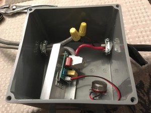

Meanwhile, I charged the keg with ~7 gallons of stripped UJ at 30% today. Tomorrow morning I'll give the new 220 electrical box/SCR a shot -- if it works, then I'll be ecstatic. If it blows up (again), it'll be OK, since I need to do a slow spirit run anyway, it'll just take a long time to warm up. The 220v gets me to drops in 35 minutes, at 110 it takes 2:45. Which sucks, but is better than nothing.
The box is as simple as it gets:
one pole goes straight to the keg.
one pole goes in and back out of the SCR
ground goes straight from outlet to keg
If that blows up, I'm as stumped as I can possibly be. Here's a shot of it:

Ya know -- if you wire nut the red wire to the power-in lead in the SCR, you'll have 220. You would have to turn it on and off at the breaker. Get some assistance if you have any questions or feel uncomfortable about it.

I've been seriously considering that, using the 220 to get up to temp, then switching to 110 for the run. But for the moment I'm giving up on the 220 and going with 2 elements at 110. I just can't wait any more. This last attempt at a controller failed as well -- even without the thing hooked up to the element, with the wires just bare for testing, as soon as I plug it into the outlet the circuit for this sub-panel blows on the main panel. SO stumped.skow69 wrote:Ya know -- if you wire nut the red wire to the power-in lead in the SCR, you'll have 220. You would have to turn it on and off at the breaker. Get some assistance if you have any questions or feel uncomfortable about it.

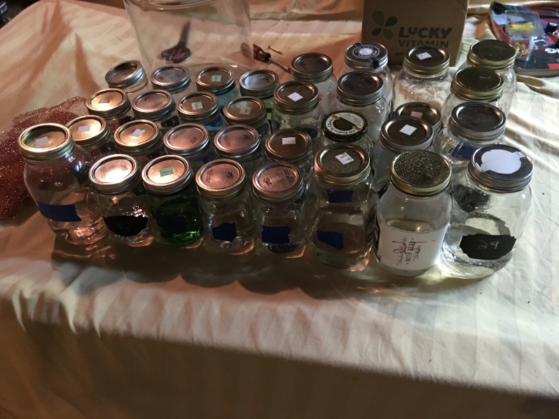

Meanwhile, I just did my first real spirit run with the keg, with 6-7 gallons of stripped gen 3 and 4 UJ. I was collecting 200ml at a time, next time I'll go for at least 250, because I ran out of jars a few times
Never done a cuts party with this much to taste, this is going to get weird fast:
In the 2 months prior to today I'd never produced more than a pint of drinkable stuff. Part of it is that I make my cuts too tight, most of it is that I was running a 5-gallon pot... It seems like a lot of work to get so very little drinkable product, but I should end up with close to 3 liters at the end of today, which feels pretty damn good.
Next weekend I go back to stripping again :]

Re: My Journey
Does that ckt bkr blow if there are no wires connected to it at all? If not, does it blow if you connect the wires to the box, but not the SCR?

Re: My Journey
If I ever needed to do an experiment with wider cuts, this spirit run was the thing to do it with. My God, this stuff is tasty.
The middle 50% is definitely a keeper, and I'm working my way out from there.
I bought some Harley-branded Ole Smokey Distillery moonshine a couple of weeks ago, and it made me feel a lot better about my own stuff. Now, I feel like a god.
I've never even gotten a full pint before, after this run I ended up with 2 1.75 liter bottles, a full quart jar and a full pint jar.
I'm working on a spicy fruit and herb recipe, so I think what I'm going to do is separate it into some pint jars and try macerating different herbs/spices/etc, then try blending them into my Dream Booze.
