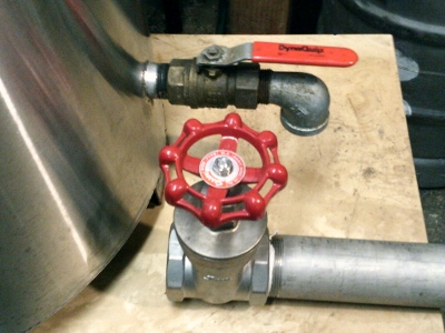

Here's the first modification.
The 1" drain valve is too small for handling mash or fruit.
This will get interesting, because the drain pipe passes through the water jacket.
Before I forget, LWTCS thanks for the idea, even if it was a bust.
If it had worked out, I wouldn't be getting on the roof in the future :lol:

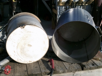

Here's a mod that will probably get done.
The idea is to increase the amount of water in the hybrid bain marie/steam rig.
Figure I'll need the extra water to keep the heating element submerged.
The downside is it will take longer to heat up.
But I've got no problem with flipping a switch earlier to make up for it.
On the plus side, you can dump and refill the mash with the hot water in the jacket.
Long story short. A second distillation could be done quicker than the first.

No real need for that Shady. If you hook the drain for the jacket up to a bucket or reservoir the jacket will always be the same level as the reservoir (close.) Less volume = less heat up time.
Posts: 12845
Re: 24 gallon electric bain marie
I didn't think of that idea.
But I've already started down this path now.
Here's what it looks like on the inside.
