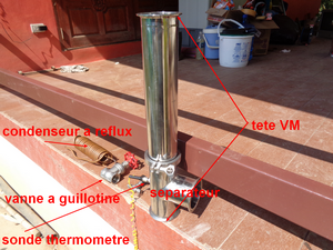

N00b here. I'm running a 3" torpedo pro column from Mile Hi (https://milehidistilling.com/product/3- ... pro-tower/)
As far as I can tell this is a cooling management setup. ( Quick aside, I don't really know if the design of the reflux condenser has a name, is' a very simple vertical pipe (1" or so) with two lines going to the side for input/output. ) I have two quick questions:
1 - Could i realistically change this to LM or VM by changing the head on it?
2 - In both the LM and VM cases it seems like there is a very good chance developing dangerous levels of pressure in the system while the takeoff is closed down. True? So if I went this route I'd want to add some precautions to address that?
Thanks in advance!

Easy enough to make a VM with that still plus a valve between the column and the product condenser. Second piece from the bottom is a reflux condenser, put that piece at the top of the column. Do not put the cap (with the thermometer) back on the top, that leaves the column open to the environment at the top (no pressure issues). As long as there is enough cooling in the reflux condenser there won’t be any vapour escaping out the top.

azeotroll wrote: Mon May 04, 2020 9:10 pm In both the LM and VM cases it seems like there is a very good chance developing dangerous levels of pressure in the system while the takeoff is closed down. True? So if I went this route I'd want to add some precautions to address that?
No still is ever a closed system, they all need to be open to atmosphere at all times , if not you have just created a bomb.
Suggest you look at still build threads until you understand that concept and how stills are built properly.

azeotroll wrote: Mon May 04, 2020 9:10 pm ( Quick aside, I don't really know if the design of the reflux condenser has a name, is' a very simple vertical pipe (1" or so) with two lines going to the side for input/output. )
That is not the reflux condenser, it's the product condenser. There are many different condenser designs and that one is a "liebig."
Edit: ... and it appears to be undersized for a 3" column. It's going to limit your production rate. Consider upgrading to a shotgun condenser after you become more comfortable running your rig.

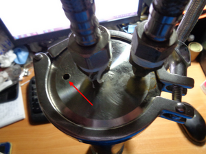

greggn wrote: Tue May 05, 2020 4:52 am Edit: ... and it appears to be undersized for a 3" column. It's going to limit your production rate. Consider upgrading to a shotgun condenser after you become more comfortable running your rig.
Thanks! The part I'm talking about is the part in red. I tried to indicate what it looks like inside with the gold fill. Those two lines go straight in and pick up a vertical 1" or so closed pipe. I put the glass section below it and the reflux generally just drips right off of the bottom of that.
I was thinking about adding a little bit of copper packing in there to help slow the vapor down a bit, if I run the 2kw heating element wide open i get a decent amount of product out. The product condenser seems pretty good, even with the cooling water running low the liquid is coming out chilled to below room temp.

azeotroll wrote: Tue May 05, 2020 7:54 am ...if I run the 2kw heating element wide open i get a decent amount of product out. The product condenser seems pretty good, even with the cooling water running low the liquid is coming out chilled to below room temp.
If I've understood correctly you're running a 3" column, in which case 2kw is definitely under powered for a column of that diameter. For any reflux column (other than plated) a good rule is to fill all of the space below the reflux condenser with packing of some sort; else its not much better than a pot still.
Just to confirm, the water coming out of the reflux condenser should be quite hot, no need to over cool the distillate being returned to the column. The product cooler definitely is over sized for the purpose, likely built to operate in a pot still configuration without the RC.

Looks like another of these so called " duel purpose" stills to me....a pot still trying to be a reflux still.
The fact that its modular is a good thing , will let you reconfigure it and add parts if you want something better.
I suspect that refux condenser will only be good for partial reflux so not much good for proper reflux still purposes if / when you reconfigure it.
Whoa, I didn't see that coming.

Expat wrote: Tue May 05, 2020 8:12 am If I've understood correctly you're running a 3" column, in which case 2kw is definitely under powered for a column of that diameter. For any reflux column (other than plated) a good rule is to fill all of the space below the reflux condenser with packing of some sort; else its not much better than a pot still.
Yep this is sort of my contraption I put together by running loose on the Mile Hi listings. The main thing I wanted was a starting point and something modular (as Saltbush Bill pointed out) so I could learn and hopefully reuse/recycle parts as I figured out what I really wanted to do when I grew up. I just got everything I need for the 240v hookup except the element, will probably order that in a month or two.
Expat wrote: Tue May 05, 2020 8:12 am Just to confirm, the water coming out of the reflux condenser should be quite hot, no need to over cool the distillate being returned to the column. The product cooler definitely is over sized for the purpose, likely built to operate in a pot still configuration without the RC.
Yep i had the water coming out of the reflux condenser at 120F for almost the entire run. We're on well water so the pressure fluctuates quite a bit but it was pretty stable.
Yeah I might actually make a smaller version of the product condenser, it's running at a trickle the whole time.
Saltbush Bill wrote: Tue May 05, 2020 1:20 pm Looks like another of these so called " duel purpose" stills to me....a pot still trying to be a reflux still.
I haven't been here long enough to know if you always nail it on the head Bill but you did here lol. This was a bit of an impulse buy after probably 5 years of planning to build one. Just got tired of thinking and wanted to start doing haha. I can't say much about the design clearly but it came out of the box like a crown jewel, gorgeous welds and polished from head to toe.

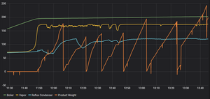

I'm partly in this to geek out as well. This is what my sacrificial run looked like. Temps in F and weights in apprximately grams/ml's. Won't go into the chaos from 11:55-12:30 haha.

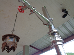

azeotroll wrote: Mon May 04, 2020 9:10 pm N00b here. I'm running a 3" torpedo pro column from Mile Hi (https://milehidistilling.com/product/3- ... pro-tower/)
Thanks in advance!
1. You can change it into a VM still,
2. therefore you need a cap, with a vent on top of the part with your coil, your current dephlegmator, then below this, you would need a T-junction, a gate valve and a reduction. I do not recommend an LM device, the Bokabob solution was very popular several years ago, and I was even about to follow that fashion, but I changed my mind and luckily decided for a VM head. The big advantage of a VM head is that it indicates clearly that you reached the tails. On the other hand, the needle valve in an LM system isn't stable (The Complete Distiller Nixon and McCaw). Do not forget some packing material like copper mesh and or stainless steel mesh or pot scrubbers. See pictures below...
I tried to show you what I have in mind...
What you need is the Ø3" Tee, the reduction and the gate valve.
tete VM en place.png (126.22 KiB) Viewed 11407 times
details of the VM head, just use your dephlegmator instead
tete vm.png (150.27 KiB) Viewed 11407 times
the vent in the cap on top of the part with your coil
