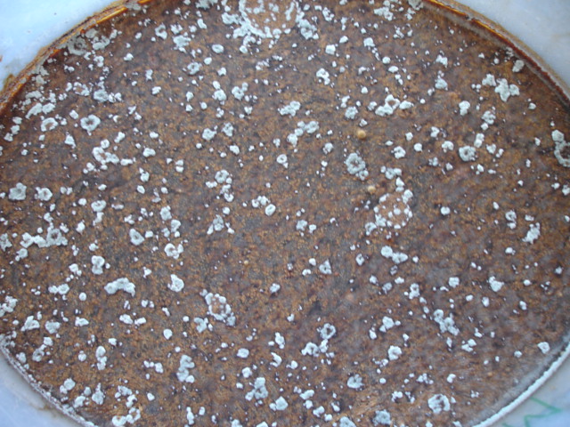

Perhaps it is a matter of time? My yoghurt pit has developed many white spots in the meantime. And my new pit (soil and potato) looks similar to yours, but also has a few white spots already (it started at places where soil was swimming on the surface). My very impressive looking white pit was not only infected with potato but also with old backset from my peated malt, and this one had much ingredients (yoghurt, cheese, potato and raw malted barley), I don't know what's working there. The basic color is still white, but it's getting more and more blue and black and I see everywhere on the surface brown crumbs or powder. And it's thick and extreme uneven, hills and valleys. I will post pictures before I mash it in a month...Shine0n wrote:This is the pit with potatoes, I see yours has a white top and mine is red like your yogurt backset pit. I wonder why that is?

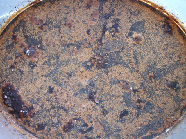

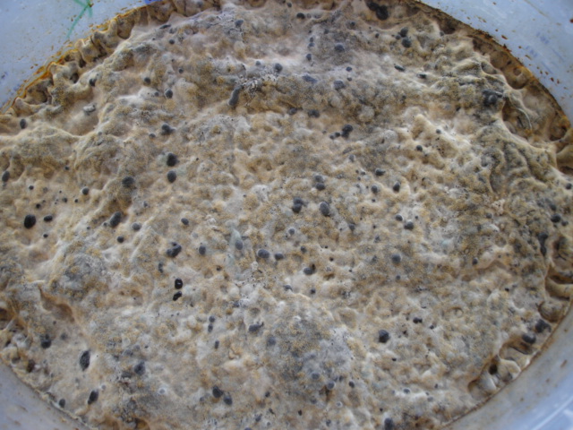

The 3 dunder pits 8.7.:
And 29.7.:
I now filled 3 fermenters with the 3 different dunders (without pellicle) and added raw cane sugar for max. 10% abv. And nutes and calcium carbonate. Then I aerated and pitched a yeast starter (fresh bakers yeast). Hopefully the yeast will prevail against the bacterias. If not, I will heat up each ferment and pitch again.In this way, imperialism brings catastrophe as a mode of existence back from the periphery of capitalist development to its point of departure. - Rosa Luxemburg

Uh....(erp!)...you plan to "drink" what comes out of those?
I guess the classic rums all start life like that. But it sure doesn't look very appetizing. And maybe, what you don't know won't hurt you...or, will it?

I never had a fail with infections. So I try a bit more this time. Yes, perhaps I exaggerate a bit.

Stripping runs of the dunder sugarheads:
First the wash with the "old Malt Whisky backset bucket" -dunder:
When opening the fermenter I recognized that there is still much sweat smell. So the esterification of the butyric acid isn't complete. I didn't fear I would get a sweat smelling distillate, but I thought I give it a bit heat and time for esterification, that I get more esters at the end. I heated the insulated potstill up to short before boiling and then switched it off for an hour. The agitator was running all the time. Then I stripped like normal. The first distillate had a very rummy aroma, then it became more fruit gum like. Then it became less fruity and therefore a bit flavorless, where I hoped for molasses flavor. Probably because it's not a molasses wash but a dunder sugarhead. I collected 3.5l low wines per 10l charge.
Then the wash with the yoghurt starter -dunder:
This is the nicest smelling wash of all three. No sweat or whatever. Nevertheless I decided for exact the same stripping procedure like the first strip, because I want to compare. The first distillate had a grassy apple flavor. Of course also Rum flavor, but less than the first strip. Then it became creamy fruity. Not much Rum or molasses flavor. I again collected 3.5l low wines per 10l charge.
The last was the wash with the "soil and potato" dunder, which stalled and smelled a bit like rotten flesh:
It still smells a bit ugly. I again used the same stripping procedure, but collected less low wines due to the lower abv. The first distillate was synthetic fruity and agressive stinging in the nose. Then it became more and more neutral, not much Rum or molasses flavor. Per 10l wash I collected 2.5l low wines at horrible low 16.2%. This tells me I had 4.5% in the wash. But only 2% was fermented alcohol, 2.5% alcohol was from the added feints.
