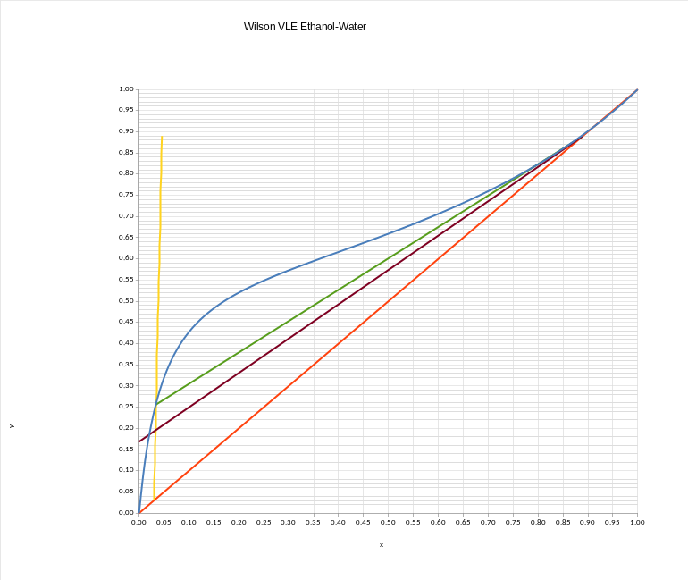

Lets examine a (partially constructed) McCabe-Thiele diagram for a 10% ABV wash, and azeotropic distillate.
The x-axis is the liquid MOL-FRACTION, the -axis is the vapor MOL-FRACTION (mf).
The blue line is the VLE curve; the vapor mf at equilibrium w/ the liquid mf.
For example the blue line has a point around [0.1, 0.43]. This means if the liquid on a plate of 0.1mf (about 27%ABV) then the vapor above is ~ 0.43mf (about 73% ABV).
The red 45 degree line represents x = y, but also has relevance to the FULL REFLUX condition.
Notes:
A 10% wash has ~3.2% EtOH molecules, and 96.8% water molecules. So the MOL FRACTION is 0.032mf.
btw a mol of H2O is ~18 grams and 18ml
A ml of EtOH is about 46 gram and 57ml
Azeotrope is ~0.895 mf
We won't worry about the'bottoms' (waste ABV).
The Yellow q-line is very important for understanding McCabe-Thiele and also for understanding reflux requirements.
The q-line is drawn from the wash mol fraction on the diagonal (0.03, 0.03) in this case) at a slpe of (q/(q-1))
q is the quality and is defined as:
q = (energy to convert 1 mol of feed to saturated vapor at dew point) / (molar heat of vaporization)
Specific heat of water is ~75.3 J/mol.K [it takes 75 Joule to rais ethe temp of a mol of water 1 degree C(or K).
Specific heat of EtOH is ~118.4 J/mol.K
Molar heat of vaporization of H2O is ~40650 J/mol
Molar heat of vaporization of EtOH is ~38560 J/mol. (**note McCabe-Thiele assumes the molar heat of vap is about the same))
If you do the linear linear approximation ...
Specific heat of 10%ABV wash ~76.7 J/mol.K, and Molar heat o' vap of wash is 40583.
Wash values are so close to the H2O values that the difference doesn't matter!
The 'q' for liquid-phase 10%ABV wash is basically (energy to heat it to boiling + energy to vaporize ) / (energy to vaporize)
where the energy to vaporize a mol is 40583 Joule.
*IF* we need to heat the wash from ambient by 80C, energy to heat 1 mol by 80C is 80*76.7 = 6136 J, so
q = (6136+40583)/40583 = 1.15, and the slope (q/(q-1)) is about 7.5.
The example shows if we heat the wash to ~12C below the boiling point, so the yellow line tilts to the right. It would ilt a little more if we had ambient wash. If we got the wash fully to the boiling point the yellow line would be vertical.
To calculate the MINIMUM number of theoretical plates, we'd assume that we have complete reflux; *ALL the vapor is condensed and sent back down - there is no product. In that case the "operating line" (a line that represents the reflux amount) is drawn through the distillate point [0.895, 0.895] at a slope equal to the fraction of the vapor that is refluxed. At complete reflux, the slope is 1 (100% is refluxed) and to the full-reflux operating line coincide with the red diagonal. Then we must stair-step off the number of plates to reach from the 'bottoms" level (not show but perhaps x = 0.0016 or 0.5% ABV loss) up to the distillate level x= 0.895 *between* the operating line(s) and the VLE curve. Minimum plates isn't actually very interesting since there is no product at full reflux, and it uses energy.
So consider if we reduce the reflux and take some product, aka distillate off (yeah). This creates a new operating line for the rectification section, and another for the stripping section. The brown line shows an operating line where 81% of vapor is refluxed and 19% is taken off as product. The slope is 0.81. We should draw another stripper operating line from intersection of the operating line and q-line to the bottoms point {from [0.035, 0.19] to [0.0016, 0.0016] }. Now when we stair-step off the plates between these new operating lines and the blue VLE line, we will get a LOT more plates. **NOTE, whenever we reduce reflux, we get more product per unit energy, BUT it requires in more plates to get the same product.
Sadly. even with an infinite number of plates substantial reflux is required. The Green line is the MINIMUM REFLUX line, at ~0.74 slope. It intersects the Q-line at the VLE curve, so we'd need to step off an infinite number of plates to make it work. This means that even if we had a vast number of plates, we'd still need to reflux 74+% of vapor.
The 81% of vapor refluxed comes from a recommended reduction in reflux for practical still design.
The energy implications are this. Nearly all the energy is involved in vaporization at the base of a still or condensation at the top. Heating the wash from ambient is a relatively small matter. To make azeotrope requires refluxing a minimum 74+% of vapor, and practically 80+% of vapor. For every mol of product collected ~4 mols must be refluxed, thus costing energy.
1 liter of azeotrope is about 19 mols, and each mol costs about 40000 J to vaporize or condense.
1 l azeo => 760 kJ = 210 W hr.
But for every liter collected another (0.81 / 0.19 = ) ~4.26 l must be refluxed, so the energy for 1l of azeo product is ! 210 W hr * 5.26 = 1110 W-hr/1l azeo.
We *might* get 1l of azeo from ~9.5 liters of 10%ABV wash = 2.5 gal.
So the energy cost is, once again, 1110 W / 2.5 gal wash = 444 W-hr per gallon of wash.
Several comments:
a) The trade offs between reflux, more plates and energy is a tricky one, that is difficult to grasp intuitively. The thing to understand is that for a a given feed, feed-quality, and target product concentration, a majority of the energy is baked into the process.
b) Pre-heating the feed, and even heating to a partial vapor state are really good and positive ways to use waste-heat. They only modestly improve the column operation parameters. Using cold feed in the vapor condenser HX *seems* like a best-use for small scale.
c) I know many here are interested in fuel or neutral beverage production, but I have to say that whisk[e]y, at ~0.35mf vapor using the left one-third of the VLE curve admits simper stills and much lower energy costs.
d) Note that "reflux ratio" (RR) is defined as the ratio of reflux return to distillate taken off a product (L/D). Full reflux is infinite RR. But this term is awkward. The slope of the operating line is L/(L+D) (reflux to ttoal condensate) and this seems more intuitive to me.
e) Steam injection as a form of heating introduces a dilution, an therefore somewhat more costly separation. The energy calculations are complex.
f) Very substantial amounts of energy can be saved by using a heat-pump that cools the (77.5C) vapor while heating the ~100C bottom reboiler. Such hardware is likely impractical at small scale.

Note that at lower product concentrations the reflux and energy costs drop and the column size drops. For example:
10%ABV liquid feed still, to get neutral spirits, practically your reflux ratio RR=4 or greater (and a large number of plates); 80% refluxed.
For the same 10%ABV liquid feed, to obtain white-dog whiskey around 68%ABV, 38%mol-fraction, requires a reflux ratio RR=0.84; 45% refluxed.
To produce a mol of neutral requires (4+1)*40kJ = 200kJ of heat
To produce a mol of whiskey requires a (1+0.84)*40kJ =73.6jkJ
Per mol whiskey distillation requires only 37% [73.6/200] of the energy!
The heat energy determines the mols of vapor, and this (almost) determines the rate of vapor flow up the column. The vapor flow (and temperature) rate is limited by "flooding" where the liquid and esp mist droplets from above fall 'upward' in the vapor wind.
So in the same diameter column, you can produce whiskey at about 2.7 [1/37%] times the rate as neutral spirits.

I need to correct/revise/clarify that.
The energy amount isn't large at all compared to the energy used for any rectification of neutral spirits from say a 10%ABV wash.
*BUT* the heating of the feed changes the angle of the q-line in the McCabe-Thiele and that can make a huge difference in the number of plates, and even the required reflux ratio for a given problem.
[Oddly, hotter feed isn't always better. For a given reflux ratio, and fixed feed and distillate concentration, the number of plates will vary in rather odd ways as the q-line (feed quality) changes. Normally hotter is better, and certainly in terms of reducing the number of rectification plates, but it seems the stripping section *may require slightly fewer plates with cooler wash for typical beverage distilling circumstances.]

Any rectification column (of a given height with a given packing) needs the same reflux given mash ABV and given product ABV, whether its batch or continuous feeddrmiller100 wrote: ↑Sun Mar 20, 2022 6:10 pm My still is continuous. It requires enough reflux to ensure the temperature gradient so the top of the column is colder than the bottom.
Stevea I believe is saying it is for example 80% reflux required if you have 10% feed and taking off ~96% product. Whether or not those 10% feed vapors enter the rectification column from a big batch pot kettle or injected into the top of a stripping column below.
To take off 2 gallons of etoh per hour you must inject 20 gallons of 10% wash per hour and inject enough heat to vaporize ~100 gallons of water in the bottom boiler, and take away enough heat to reflux 80 gallons per hour at the top of the column.

Because Stevea told me this a few replies up, referencing his graph.
*some* amount of reflux is required, i'm not a chemical engineer, but it sounds like Stevea's information is the precise amount of reflux required to get to 95% product from 10% feed.
drmiller100 wrote: ↑Sun Mar 20, 2022 7:24 pm
Also you went from 20 gallons per hour to 100 gallons total. This is not a pot still. It is continuous.
My understanding of the theory, is that packing or plates or a very tall column all accomplish the same thing, rectification wise (but are very different in terms of clogging, cleaning, etc).stevea wrote: ↑Sun Mar 20, 2022 3:55 am Reflux costs energy b/c for every mol of reflux you must add 40kJ to vaporize it, then remove 40kJ to condense it. BUT, to get sufficient concentration from a liquid-phase 10%ABV feed, to produce neutral spirits means that you must reflux ~80% of the vapor, while collecting only 20%!. That is the expense.

Yes it is true. Examine the McCabe-T diagram posted above. Find 10% ABV = 0.032 mol fraction on the X-axis, then go UP and see this intersects the VLE curve at 0.25mf on the Y-axis; and 0.25mf = 53% ABV. What you have described (10%ABV liquid to 50% ABV vapor) IS one plate of separation - just as I said.... This is just not true.
Feed beer at the 10th plate of a 10 plate beer stripper and you don't need one bit of forced reflux to enrich from 10% to 50% .
Stripper comment:
I really don't get your terminology, nor explanation. 'FLASH' distillation is a very real thing (involves lowering pressure to instantaneously boil-off a fraction of feed) , but definitely NOT happening here, nor in an isobaric(common) still, Your 'point flash' means little to me - explain.Much of the alcohol flashes early. But some alcohol does make it's way further down the column to at some point flash. This is the catalyst that enriches the beer column with no reflux notwithstanding the continuous beer feed of 10%. Ah!! The beer feed.
In a stripper your plates are operating between the VLE curve and the "stripping operating line" which is actually pretty easy to derive from theory as a straight line on a McCabe-T diagram.
In an isolated stripper (no overflow from rectification, which changes the op-line), with feed near it's boiling point, it takes a very large number of plates to get product vapor that is fully "one plate better" than the feed (say 10%ABV to 53% ABV). however you can get very close with a modest number of plates.
My description would be that the feed at the top plate absorbs high enthalpy, lower ABV vapor from below and this causes an exchange the released higher ABV vapor product. The next plate down loads with partially depleted overflow wash from above, and it too absorbs higher enthalpy, lower ABV vapor from below and ... I've a McCabe-Thiele spreadsheet, and I converted the values to ABV% so in such a stripper we see ...

10 0.13% 1.28%The MOST effective plates on a molar basis are plates 3,4,5, NOT the top plate as you seem to have suggested.
The explanation is clear if you examine a McCabe-T with a stripper operating line drawn in. The bottom plates don't vaporize a lot of mols of EtOH b/c the wash is too depleted and low ABV at the bottom. The top plates also don't extract as many mols of EtOH b/c the vapor from below is already near the VLE limit. IOW The 50.27%ABV vapor from plate2 can't do very much depletion from a 10%ABV feed at plate1, which has a VLE limit of 53%ABV.
BTW - it's true that you can add more stripping plates and lose less EtOH at the bottom at essentially no energy cost. I think I misunderstood the calculation in Miller's "Whisky Science ..' book.
If we don't understand this very-basic white-board (theory), then we CAN'T understand the concepts, and we CAN'T see the obvious truths & errors. You made two gaffes here. You didn't see that 10%ABV=>50%ABV vapor is one theoretical separation plate; that's about reading a VLE curve. You didn't (seem to) see that the effectiveness of plates (stripper or rectification) is related, in a McCabe-T to the vertical height of the stair-steps AND that those steps become small when constrained by the stripper operating line. Only in the past few months after manually constructing some McCabe-T diagrams did the huge importance of the q-line, and the two operating lines dawn on me. It incidentally explains the energy needed to drive a continuous still, and the peculiar issue of minimum required reflux to get a target separation.Less white board and more practical application please.
