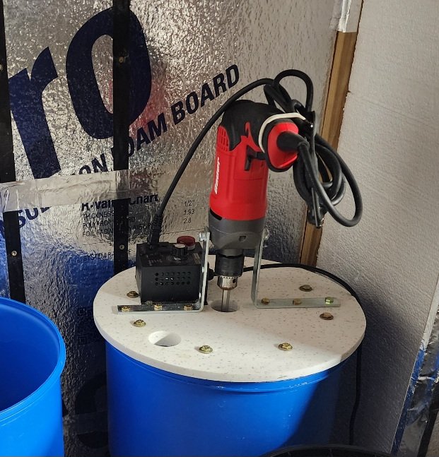

Hi Bee. Photos are working again so thought I'd show you my mixer. It's sitting on a 14 gallon fermenter, inside my ferment cabinet. You are correct, I am mixing the hot water and grain. This is my basic procedure and happily open to critique if I'm doing any part wrong. After some advice from one of the guys here I started poring my grain meal into the water instead of the water into the grain. It definitely makes mixing easier. This is the only thing I changed in the mashing process from corn run #1 to corn run #2. I use a large paint mixer and get the water moving then slowly pour in the grain. I have also been adding a little powdered amylase at this point to help get things thinned out, it denatures quickly but it gets you to the next enzyme drop without ending up with breakfast instead of mash.
I drop the mixer on and get everything moving good, use a big funnel in the hole in the lid to add in malt, or enzymes when the temp is right. There's a plug for the ingredient port when it's not in use to preserve the heat. I also insulate the fermenters and the lid is a double layer of Corian solid surface, the lower piece fits tight in the top of the fermenter, so it holds in the heat as long as I need it to. I had been letting my ferments cool over night but I just picked up an immersion chiller to speed the process up and to hopefully avoid any nasties growing in my stuff.

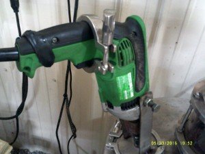

Nice mixer, if the speed controller ever takes a shit here's a manual way to getter done.

shadylane wrote: Mon May 26, 2025 6:13 pm Nice mixer, if the speed controller ever takes a shit here's a manual way to getter done.
HA! That's great, I love the built in ability to adjust speed.
You're a genius, Shady! :thumbup:
