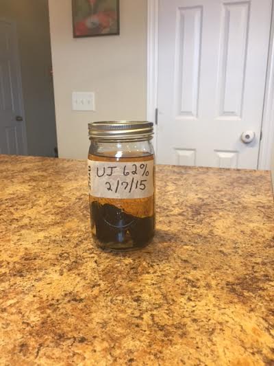

I read thread awhile back , thought it was an excellent write up and decided to give it a try. I had always used the toasted cubes from the brew shop in the past.
I didn't have any oak on hand but I did have some apple, something that I always have since I am pretty heavy into smoking foods.
My process was as follows:
1) Toast some apple chunks at 400 deg. for about 1-1/2 hours
2) Light char with the propane torch (same as the TP video)
3) 16-20 sq. inches per qt. seems like a good number however I just eyeballed mine due to the odd ball shapes of the chunks
I put these in some 2 week old UJ at 62%

Looks good already!
I remember others using applewood for flavoring so this should work nicely.

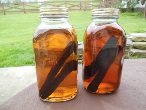

Here is 2 Old time half gallon jars probably 50 yrs old, with UJ made 2-3-15 bottled at 122 proof. 2 White Oak charred sticks per half gallon jug. I check the taste on this stuff every few days...after someone made that comment about the taste getting like licking a BarBQ grill.
So far, it looks great and tastes great. Maybe I should pull the sticks out?? Or leavem in?? pullem out and leave it sit??? Or call the neighbors in for a party. paper towel standing by to filter it with......
