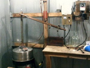

Posts: 11541
Re: Building a boiler out of a sand filter
I'm making a very simple pot-still head to connect the boiler to a condenser.
When I say simple, I mean simple. The condenser is 1" so the riser will be 1"
That means something will be needed to connect the 4" ferrel on the boiler to the 1" riser.

Posts: 11541
Didn't have enough 1 inch tubing in the scrap pile, so I had to use 1-1/2" for the riser.
I cut a copper disk out of some .065copper for the ferrel connection and welded it to the 1-1/2 tube.
I then drilled a 1-1/4 hole from the bottom and welded it again.
The copper is now real soft since it was annealed by the heat, so I'll hammer on it to make it hard again.
The top part was easy, I drilled a 1" hole for the union and brazed a piece of scrap on the end, then trimmed off the excess.
I also added a piece of tubing on the end, for the pot-still thermometer.
Haven't cleaned it up yet, but I'll get to that tomorrow.

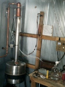

It's working just fine. I modified the legs and downsized to a 1" drain.
Here's the boiler set up with a 4" CM column.

Posts: 11541
Here's the dephlegamator build. The product condenser is 1" inside 1-1/2"
One of these days, I'll get around to re-plumbing the cooling water valves and put flow gages on it.
http://homedistiller.org/forum/viewtopi ... 50&t=57949

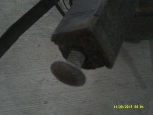

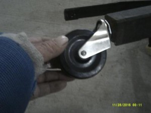

I took the adjustable feet off the legs and put on some caster wheels
