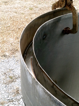

I haven't welded anything yet, since I'll probably have to do some more grinding and hammering.
The big ring on top, that seals the water jacket was a pain in the @$$

Re: 24 gallon electric bain marie
I'll probably cut 3" off the top of the outer water jacket and 4" off the inner boiler.
Some of the left over SS, will be used to make the outer lip for the water seal.
I've found a really big SS bowl on amazon that would make a perfect cap.
Or, I might hillbilly engineer a lid from my junk pile.
Using split copper tubing and the copper bottom from a BIG coffee pot.

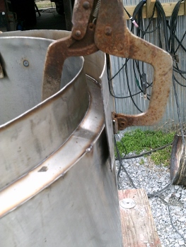

- Posts: 12507
Tack welded some of it together and started trying to figure out how to make the outside lip for the water seal.
I might do it this way

Don't forget to make the outside wall just a little taller than the inside.

Here's how I might do it.
- Posts: 12507
Welded until I ran out of argon. I still have a lot more to do.
The outside lip for the water seal will be welded last.
After I've pressure tested the welds, that I can't get at after the outside is welded on.
