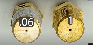

May be my question wasn't clear; it's more about using LM column for a stripping run. Can you run it until 98C?
For neutral, I understand you can rely on the 1 degree variation or taste buds.
Posts: 10550
Re: VM, CM, and LM confusion
AFAIK those stills have a restrictor in the outlet that sets the reflux ratio , so the still can’t really be used for stripping . I believe some come with an optional oversized restrictor but it still isn’t a true Potstill unless you can bore out or remove the restrictor . Then you should be able to use it as a Pot still .
You could just go buy a nipple from a plumber or hardware. store to replace the restrictor if you don’t fancy drilling out the one you have .
The temp is a reflection of the ABV at the top . Once all the alcohol is removed and the reflux action can no longer maintain the high ABV , it will start to fall and as a tesult , the temp will start to rise .
So yes it is possible that the temp at the top will get to 98°C .And certainly , without the restricter and running as a Potstill it will …. Just like a real one
I would also agree with Saltys comment above though with regard to stopping when the temp rises by a degree .
This is shutting the stable door after the horse has bolted .
The compressed tails will already be coming over at that point and contaminated your collection if you are not using multiple jars to collect in .
The manufacturers of the still assume that the operator has no experience and therefore will not know when to stop collecting . So they say stop once the temp has risen 1°. Most people wouln’t taste it so they get away with it .
I urge you to actually have a taste of that stuff coming out the spout when you see the rise in temp .( get a half a teaspoon of water and hold it under the spout and collect a few drops and taste) .
I promise you once you have tasted that vial shit , you will switch to using small jars so next time so you’ll be keeping it out of the mix .
Also regarding the initial cut . Have a taste of that first stuff that comes out after you have discarded the recommended 150mls or what ever it is . I think you will dicide to discard quite a bit more . :ewink:

Yummyrum wrote: ↑Sat Jan 28, 2023 2:48 pm AFAIK those stills have a restrictor in the outlet that sets the reflux ratio , so the still can’t really be used for stripping . I believe some come with an optional oversized restrictor but it still isn’t a true Potstill unless you can bore out or remove the restrictor . Then you should be able to use it as a Pot still .
Thank you so much for this detailed reply. It totally makes sense.
I assumed that within the 1 degree variation, I would collect very little heads and tails, but I understand they are really compressed and I probably get more that I want! it does make sense.
I will definitely collect in small jars from now on. I need my neutral to be excellent!
Getting a nipple from hardware is a great idea for a stripping run. Would also save me some time I assume.
