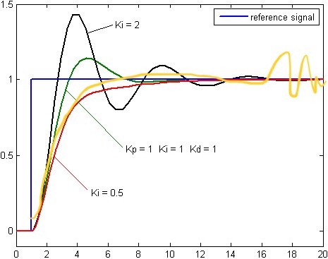

I'm thinking and might be wrong
Since the boiler temp is gradually rising as the alcohol boils off
The boiler temp will never overshoot for the controller to learn from.
Thank you charcoal for your graph I'm using :thumbup:
A PID will try to learn and copy the above operator and will show results like

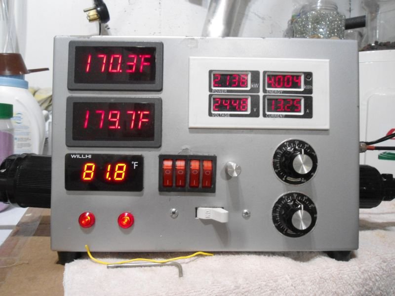

So to continue with how I use temp probes, here are the temp probes numbers, as taken during a run done today..
The run consisted of a grain base spirit of 95% - diluted to 43% of 6 gal boiler load, for a re-run.. re-run for the reason of reducing the acidity of the spirit, reducing the Ph level, from a Ph of 5.5 to a Ph of 6.8, once it was diluted to 50%.. reason for the re-run of once at 95%, was for in the making of herbal tincture..
So here goes.. the unit used is a concentric design, 2" x 36" packed with 1/4" lava rocks, 7 gal boiler keg, with 5500 watt element.. note that the steady reading of the top meter, reading 170.3*F is giving an 95% abv at the rate of 2.25 litres per hour in the body..
In first picture (Start of run) the top meter is indicating a temp of 170.3*F from the temp probe located at the top column, just about the packing and just below the vapor throat body.. the meter just below the top one, indicates the temp of 179.7*F from the temp probe located just off the base of column, in the vapor pooled just below the column base.. and the other smaller meter indicating the water temp at the outlet of the reflux condenser..
Note: the temp of the vapors near the base of the column indicate the level of the alcohol abv at the start of the run.. also note that the run has been in reflux mode for about 20 minutes at the time of the picture, and was just at the start removing a small amount of fores and heads (100ml all together)..
The second picture down, the middle meter indicating a reading of 183.2*F from the temp probe, indicates that by the temperature reading that the end of the body section is nearing.. around the 184 - 184.5*F is the transition of the body and the tails.. note that the top reading is steady at 170.3*F and that has be producing an abv of 95% abv.. and the water temp is stable at 81 - 82*F range..
The third picture down, the middle meter indicating a reading of 190.8*F from the temp probe, indicates that by the temperature reading that the run is well into the tails section (early late tails).. from 189 - 194*F.. just that period, in a normal run, I would be collecting compressed tails in small 200 ml amount, and may or may not add them to the body once they've been air and sampled..
The fourth picture down, the meter indicating a reading of 200.6*F from the temp probe, indicates how deep into the run I went.. remembering that this run was about a re-run run, and want to exact as much of the alcohol as possible.. remembering also that this run start off have the cuts done in the previous run, so there were basically no heads or tails to talk of..
Note that the top meter indicates a 170.3*F reading, indicating a 95% abv take off.. also note that to maintain that level of abv, one has to manage it by reducing the take off rate.. also note the the power usage (amps) was slowly increase during the run.. this was done to maintain a level of refluxing to take place..

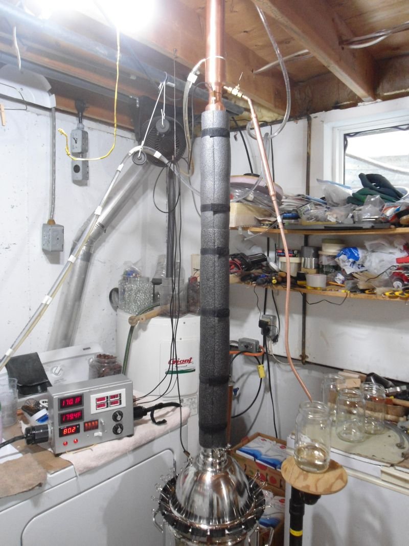

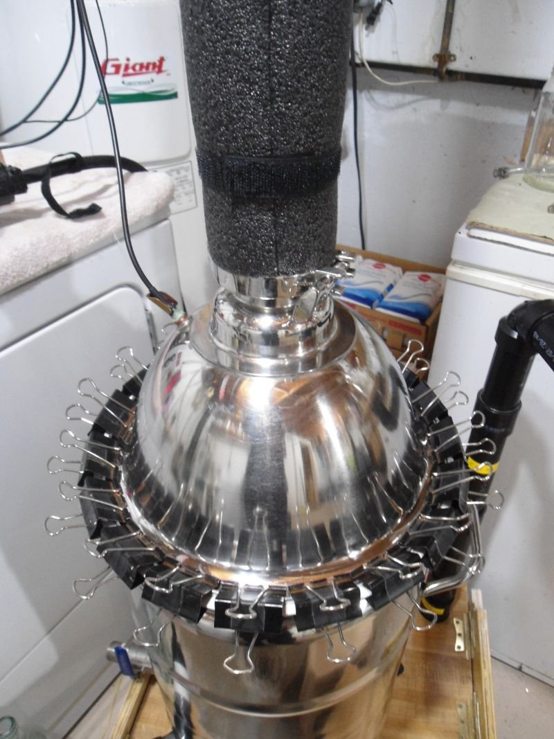

Below are pictures of the unit used in the above post recording the activity, plus the location of the temp probes..
The first picture down show the concentric unit used in the production of the spirit run..
The second picture down show the location of the temp probe in the vapor path near the base of the column..
The third picture down show the location of the temp probe at the top of the column, located about 1.5" above the packing and just below the vapor throat, and is protected by shield so to not have any reflux dropping on it..
It also the the location of the temp probe monitoring the temperature of the water flow at the outlet end of the condenser..

StillerBoy wrote: Sun Feb 16, 2020 5:14 pm Note that the top meter indicates a 170.3*F reading, indicating a 95% abv take off..
Sounds like the temp probes are as inaccurate as mine
Or your locate farther above sea level :lol:

shadylane wrote: Sun Feb 16, 2020 6:28 pm Sounds like the temp probes are as inaccurate as mine
It would seem like you are just reading bits and pieces, here and there.. lol
StillerBoy wrote: Sun Feb 16, 2020 12:25 pm Each temp probe meter is within a tenth of each other, and all reflect the exact temperature in their reading.. took a few extra probes to get it there, and it doesn't matter which probe I plug into a meter, they all give the same reading.. so the meters are good, it just the probes that can be off some..

I've been running my units with the controller pictured for over 7 yrs now.. always learning the fine tuning required.. i do reconize that one has to start somewhere.. but in the end be a pot, a reflux unit, a flute, the principal of distillation is all the same.. just a slightly different behavior of vapors.. that what I teach a new comer first of all, then how to make a wash that's done in 3 days, then he can decide what unit he wants and what product he want to make..

Take a longer look at your probe installation
It doesn't look like it's very insulated from the outside world
So It's not just measuring what is happening INSIDE the still
