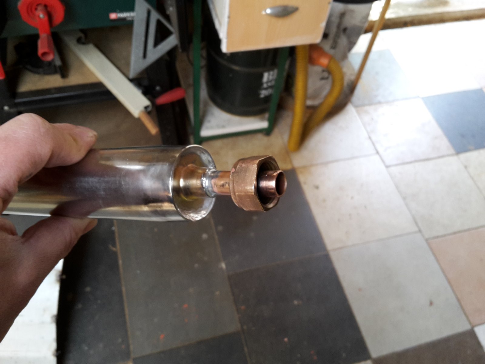

Glad to hear it works well..
A question.. what I see from the picture, the condenser is welded to the column piece.. and what is holding the outlet/spout piece to the shotty..

Re: Shotgun Proportions
Yes, the final part is a spout that can be removed and is telescopic to adapt the length. I thought for a while and then I decided to adopt this system trying to adapt the pieces I had. I use soldering because where I live it is impossible to find tri-clamps, the same goes for large copper pipes.

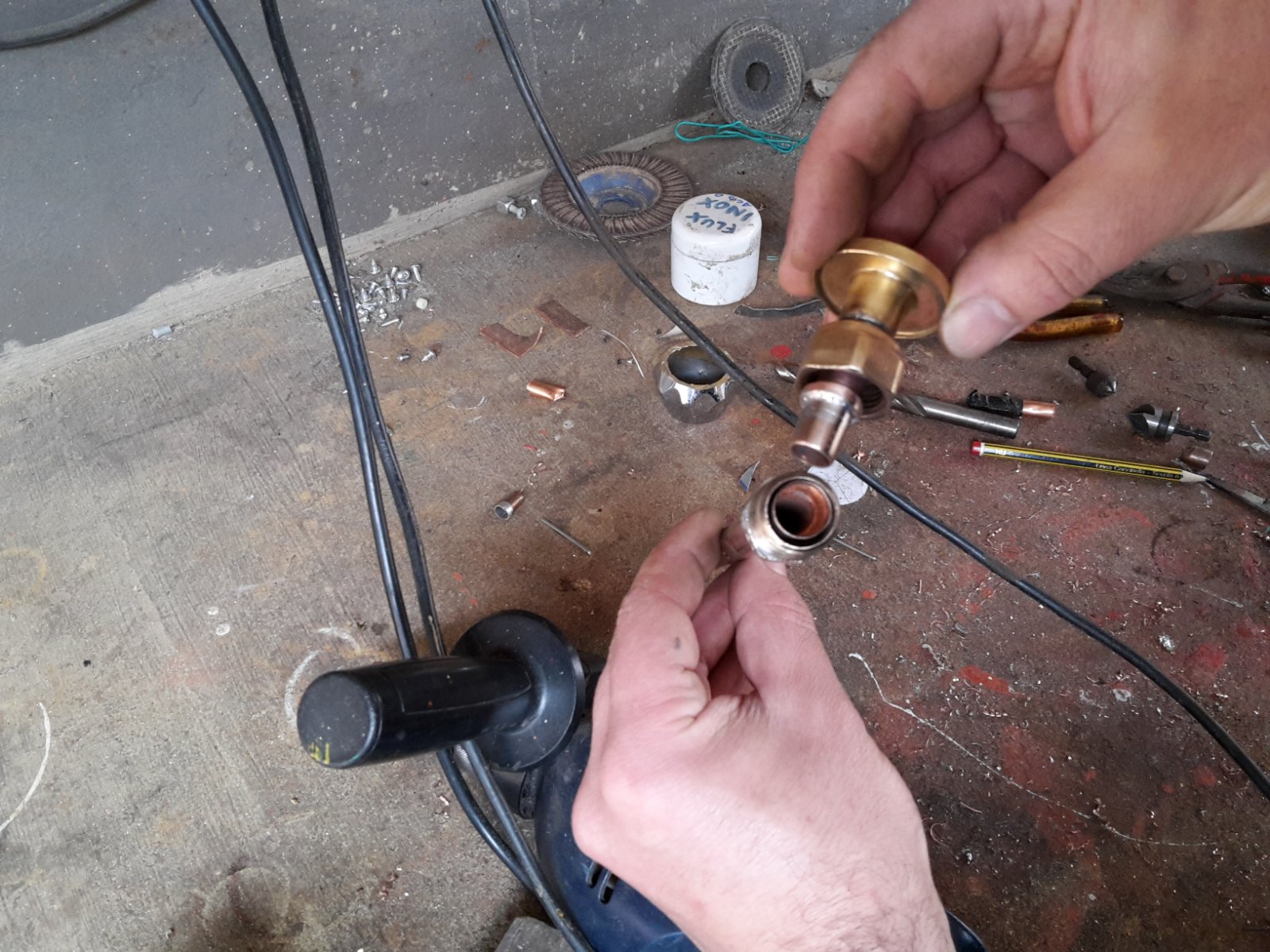

So in the eventuality it requires clean, how do you plan cleaning the unit.. and as a starter, say cleaning the flux used in soldering..
I cleaned everything possible before welding to the column, then after welding to the column I cleaned and brushed the parts welded through the top and the opening of the glasses, the welds are external in that point. I then cleaned with citric acid and alkaline detergent, rinsed thoroughly and distilled for 2 hours with waste alcohol. I don't think it needs a total disassembly for the ordinary rubbish, from the opening at the top of the column I can see the gun tubes, a little detergent fill the spaces and a little shaking will be enough to clean all the parts. There are forum members who only use water for cleaning.StillerBoy wrote: ↑Tue Mar 02, 2021 2:35 pm So in the eventuality it requires clean, how do you plan cleaning the unit.. and as a starter, say cleaning the flux used in soldering..
