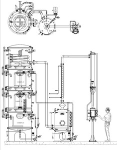

Found this picture online... gives me the idea that it may not be terrible to try this out on a small scale... yes work, but not impossible. I love ryes and rums enough put in the work... just part of the fun for me.
So imagine this infusion/thumper setup pictured, but with 4" (or 6") x 24" spools (or 5g pony kegs) and just extend that copper thumper spout down to the bottom of the spool.
Only thing I'm really struggling with is preheating the next charge... anyone got any ideas?
After watching that Jamaican distillery interview it looks like they start it with water in the lower chamber and once middle chamber has been stripped they drop everything down a level and that's when things really start... I imagine that distillate from that first half batch could be added to your last half batch to complete the run although those two might be a bit off flavor so they should be saved on the side and evaluated individually.

Ok, I've been obsessing over this for far too long to give up and use kegs. I think I can do this with 10" x 12" spools (yes I know, not quite tall enough to get the 4psi in the Leopold 3 chamber) and 1. 5" tubing (for the plumbing) for about about a grand.
Doing this vertically and charging the "right" way is the only way to make the labor not completely ridiculous. (I know i said above it would be worth it, but shit man... that's a lot of work 🤣)
10" of liquid height x 10" diameter pipe = 785cu in or 3.39gal per chamber. If I make a 40 plus gallons of 10% wash I'd be able to cycle this enough times that this could be worth doing on a small scale.
I guess I'll try to make cuts the best I can but from what I've read heads and tails are going to be smeared throughout. So this may just turn into a really expensive double retort but eff it, part of the fun is building stuff.

Agreed, it would be cheaper to do the kegs... but juggling the kegs around, dumping and refilling seems like a big waste of time. Also, my brother owns a fab shop the most the welding is gonna cost me getting to hang out with him and buying lunch... I ain't hating on that 😂
The big reason I feel like doing this as designed is important is something I didn't see mentioned here or in the SD thread. By stacking them vertically and using the preheater, the preheater when newly charged is going to be cold (or at least room temp), it seems to me that there will be a good period of full reflux at least until it gets up to temp enough to start allowing distillate to start passing. This full reflux "should" be causing some esterfication time and may have extra benefits we haven't discussed, as we are now going to be thumping though each charge of esterfiied wash twice and boiling the snot out of it. I don't know the science enough to say, but it seems to make sense to me that we would be getting a lot more opportunity to pull those flavors out.
What say you guys with that esterfication knowledge?
