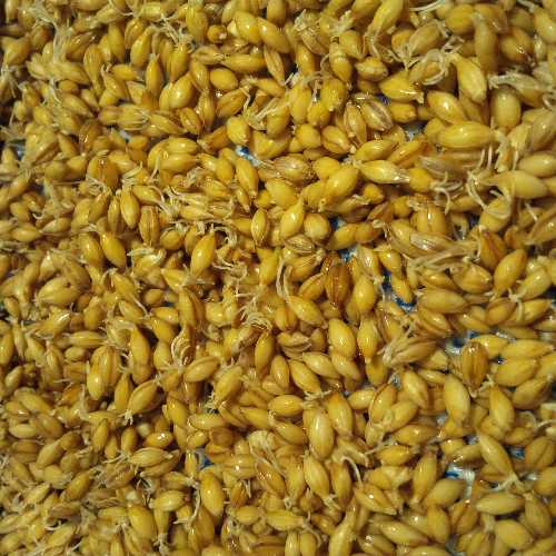

I realize this is an older thread, but with so many talking about wanting to make their own malts lately, as I myself do, perhaps a little revival and possibly some new input to help.
Malts are unavailable locally for me. The alternative is ordering and shipping, and that's pricey. So I've been using liquid enzymes to stretch out my malt use after finding most grains without malt and enzymes are lacking in the final product. So a little malt is good
So, I decided to see how my local feed store barley would fare out if I tried malting. I tested a batch to see if it was worthwhile going further, building something to allow me to upscale. A few handfuls for test suggest it is. Mainly reviving this for others. The info is here in the forum, read up and save cash, gain knowledge, and personal satisfaction!
*edit to add second pic
