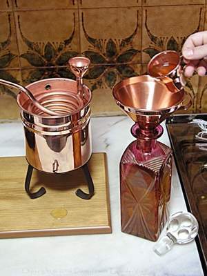

This the still guys and the distillate, notice the color on the board and in the decanter

real schnapps is clear either distilled wine or "clear" alcohol, flavors added then redistilled. (unsweetened ,brandy in the white)
flavored vodka is vodka with flavors added.
liquors are alcohol (your choice) with added flavors and sugar.
(all but here in states ????? in witch they sell liquors as brandy,, flavored vodka as schnapps)
