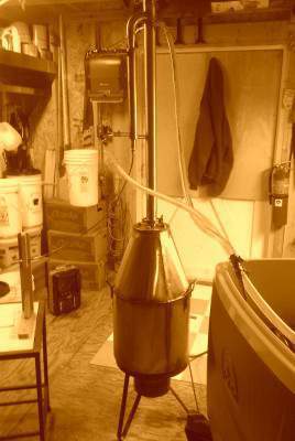

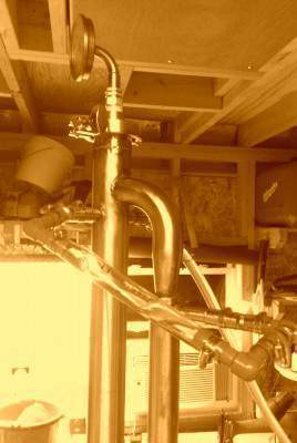

Here ya go, American Road Iron, Ya want to go $100? LOL

shiner51 wrote:Here ya go, American Road Iron, Ya want to go $100? LOL
You want to check the gas you used before I drive to fort woth to pick up my $100.00. And if you used argon, I want to come there and you show me. We do reccomend argon and 1% ox or even a % of co2, or even tri mixes. But this would be new to my toolbox using pure argon. Let me know, you now have my attention.
