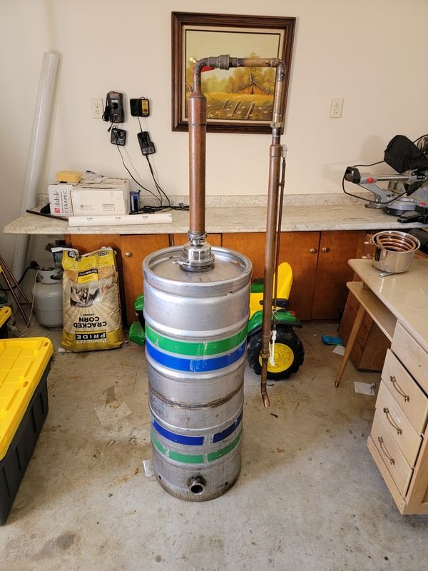

Scored this little rig for $350 from a guy that's going legit and needed space to store his new 500 gallon column (drool).
She aint purdy yet, but I expect she'll shine up nice (pun intended)
It has a 26 gallon boiler (2x13 gallon kegs welded together) with a 2kw and 1.5kw element (no controller so I will be plugging the element ports and running it on propane until I have a better understanding of electric stills), reflux column with internal coil (VM I believe), and a 3/4" inside 1" leibig condenser. Former owner said he had the bottom (2kw) element plugged in 100% with no controller and used an inkbird with the probe at the top of the column to operate the upper (1.5kw) element to keep temps where he wanted them. I'm not sure if that's the route I want to go, but please let me know what you guys think.
I will likely rebuild the column with T/C fittings to make it more modular and make some slight adjustments to the design. I intend to run this as a simple pot still but I couldn't pass on the package deal so I'll keep the existing pieces for any future projects once I get some experience under my belt. I think I'll keep my eye out for a 1/2 barrel keg to convert into a thumper, but that will probably be down the road a ways.

That's sweet.
Were the bottoms cut off both, so there's a tri-clamp on bottom also?

That seems like a great way to get smearing to happen. By cycling an element on and off in response to a temp at the top of the column you'll be pushing tails up the column. A simple eBay SCR style controller should happily take care of one element (personally I wouldn't put more than 2.5kW onto one of the supposed 10000W units!). I would run the 2kW one as the controlled element (because it's at the bottom) and use the 1.5kW one as a heat-up boost.bcook608 wrote: ↑Mon Feb 14, 2022 9:27 pm Former owner said he had the bottom (2kw) element plugged in 100% with no controller and used an inkbird with the probe at the top of the column to operate the upper (1.5kw) element to keep temps where he wanted them. I'm not sure if that's the route I want to go, but please let me know what you guys think.
I thought that sounded kind of weird too. Plus the fact that I hadn't seen anything CLOSE to that on here led me to believe that it probably wasn't the best option for running. I might step the 2kw down to a 1.5kw as I don't have a 20a circuit in my garage (I don't think, I'll have to double check.)
I was thinking about switching to a controller
I just get intimidated by electricity because most of my research and attention has been focused on remembering the tips and info relating to running a propane boiler. Guess I'll have to go back through and see what I can find on internal heating.
