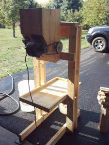

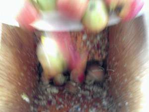

Hi All,
Bigger is better :D My stills grew from 2 to 8 to 15.5 gallons, and the need for more cider led to bigger and bigger apple grinders. The first couple generations; juicer, then a garbage disposer mounted in a spare sink outlived their usefullness for anything more than a small qty of final cider to ferment. Last year I built this and it chewed through 360 pounds of apples in no time. This year I went nuts and picked 1017 pounds of apples. It took me a weekend to chew thru them all and press them up with this grinder/press. Also brewed 2 batches of beer in parallel so it really wasnt that much time total, few hours. Each batch of apples, a 5 gallon bucket full, about 23 pounds, half a bushel, took me about 10 minutes to sort, wash, grind and press, giving up a gallon + depending on the apple variety. The grinder and press has held up great. about 1400 pounds of apples so far. The axle has a few wraps of heavy teflon tape on the screw threads where it goes through the end boards to act as bearings. Also, there's a 1/4 inch thick 5x5 metal plate mounted where the hydraulic press hits the top board so's not to mash up the wood there. The plastic basket finally blew apart with about 100 lbs of apples to go. I wrapped wire around it to get through the apples and will build a proper oak slat basket this winter. I have a painters screen sitting in the top of the catch bucket, works great to catch any chunks. I got that one at a bee supply house for catching wax and bee wings etc when harvesting honey. The cylinder on the grinder wheel is a chunk of pear tree trunk that I filled with rows of stainless steel screws for teeth.
Cheers, Jim

I really like the grinder. Now I will have to make one of those. I made my wine press with a 5 gallon bucket with 3/4" holes in it just like yours. I use a lever to press unstead of a jack, and so far no problems with the bucket. But I havn't tried apples yet. Just grapes, and the pommice comes out very dry.

Very nice, I posted pictures of the one I use about a year ago. Group of fellows made it out of stainless down at the pulp mill before they closed it down. The strainer is an old stainless steel filter used at the mill, last weekend we put up 39 gallons, great fun currently have 19 gallons fermenting.

Thanks JD and Bushman! It works really well, the only thing I want to change on it is the press supports. Right now 2 ea 2x6 top and bottom. The 4 ton hyd press presses between them against a 1/4" metal plate where the press head hits. I only get about 2 gallons avg per bushel. Its a little on the low side (2 1/2-3 is good), and the pomace seems a little wetter and heavier than I like, and the supports are starting to creak and crack under full pressure. I'd like to get some steel in there, but not sure how yet, it will depend what I can find. And then Ill pick up an 8 ton press :ebiggrin: That motor was off an old scrollsaw, its only 1/3 HP. I was worried it wouldnt be enough but it doesnt even slow down under full load. Frankly I think they rated motors more accurately 50 years ago, :silent: but Im no motor expert.

Thanks Hawk, it wasnt too bad to build. A weekend or so of horsin around. The only part that didnt work right out of the gate was the cylinder loosened up on the axle. I had to take the hopper apart and then countersunk a 1" hole on each side of the cylinder and used 2 nuts on each side against 1" washers, as tight as I could get the mothers. Ya 1400 lbs is a shitton of apples. With trees overflowing and no cost its hard to stop picking. especially knowing each 5 gallon bucket full is about a fifth of brandy. :ebiggrin:

Nice set up jimdo64, I think we think alike . I like the way you set every thing on one table set up nice ! does your apples feed through the grinding head ok with out pushing them through? reason I ask I built one simalar last week tryed it out yesterday the apples dont realy pull into the heads that well. wondered if you have a tryed and true aproach for the feed set up If you dont mind me asking. I need to push them a little with a block of wood , then thery grind up lickidy split. thought I would up my rpms see what that does.............. pic of my set up , see what you think any insite would be great............happy grinding.....wfw

That looks great wfw52. Proper bearings too, nice, where did you find those? I sometimes wonder how long my teflon tape bearings will last :) So far so good tho no signs of anything wearing out or getting squirly after 1400 lbs of apples :)
No I dont need to push them through unless I fill the hopper, then they do get stuck. It eats them as fast as I can grab two handed handfuls and drop them in, or roll them out of the bucket pretty fast. 23 lb 5 gal bucketfull gets chewed up in a couple minutes. Does yours work fine throwing them in like that? Your hopper looks great, and the angles dont look any different than mine. Maybe slide that rear board over the grinder forward (or add another) so the teeth hit the apples first with more down angle to help push them through and not fight gravity?
The way I built mine the hopper, grinder, motor and everythign is one self contained unit. Its just bolted to the side of the press for convenience to let gravity be my friend and the pomace drop right into the press bucket. I did that because I wasnt sure if the press part would hold up under TONS of pressure. As it turns out, the top 2x6's are starting to crack. Im gonna replace them with oak and maybe try to get some steel in there.

Looks to me like the space between the teeth and where the apples get crushed and pass through is wider in jimdo's shredder. The narrower gap would cause the apples to dance a little more. Just a thought based on what I can make out from the photos.

thanks for the reply Nchooch, and the complament Nchooch, ya I agree it needs ajustment on the throat , the apples bounce up mostly when you drop 1- 7 , when filling hopper it just sits there , hence pushing them down . I see your pulley size on your grinding wheel is smaller than mine giving you more rpms. have already change my motor pulley up 4 sizes see what that does , running a 1/2 hrs so have plenty of power. making the throat ajustment next see hwat that does ..... gotta run pick more apples while it stopped raining !!! then give it a go today . lotta of apples this year want to get what I can :thumbup: have 15 gals apples ready to run , 5 gals of grape tailing , no time with apples going to waste out there last of the season here in Washington.

Yes Jimdo I did , made a change in the angle of my screws ( tipped them back ) all 64 of them ! :( but man you cant feed it fast enough now !! 5 gal bucked full in about 3 minutes . what a differance that made ! also since your into this though I would share another Idea on the subject see what you think. the shreded apples are great ........but it seems to me one could take this a step futher beacuse the small bits that you press are still chunky and after you press them leaving a far amount of juice in them after pressing..........SO........ I know your on the edge of your seat !! lol ... what if a guy made up 2 - 5 inch oak rollers and dadoed a 1/2 by 3/8 deep grove space 1/2 in apart on both roller then space them allmost touching , rotating then inwards to each other so they would pull the just shreaded apples in and crush them finer
. you woukd need a tray under your bucket to collect all the juice from that. Then run them through the press . I think you could get at least another 1/3 the volume from your apples ??? ( if that makes any sence) I need to do this !!
