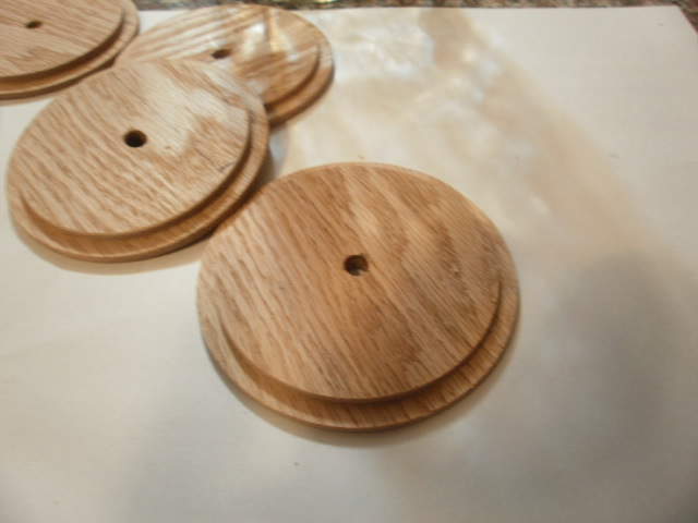

I had a wild thought and decided to try this. Everyone talks about how using Mason jars won't let the aging whiskey breath . so I went down to Lowe's and got a small piece of 1/4 inch thick white oak and made some replacement caps for my mason jars. I am going to toast them and soak them for awhile and see what happens.

That is a clever idea corene. I was just looking around for something to layer in there between the metal flat piece and the ring, like a sheet, film, or gasket. I store at about 50%, I'm not sure it's an issue but this is a good way to handle it.
Re: Oak lids for jars
How did you make them? Lathe or hole saw and router or something else?

I cut an over sized blank with a hole saw then made a mandrel for the lathe to bolt them on through the center hole and turned them to size then hit them with a bit of sandpaper to smooth them. Just thinking you could probably do the whole thing with 2 hole saws. Get a smaller one and run it 1/2 way into the wood then use that pilot hole and cut the whole thing out with a bigger hole saw and clean up the edges.
I am toasting and soaking , not to add flavor but to make sure there are no impurities from manufacture left in the wood. I was thinking too that toasting might open the pores in the wood so it could breath a little better. Some day I would like to get some small barrels but they are out of my price range right now. I only have about 75 cents apiece in these lids if they work.

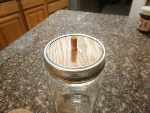

I was thinking of that so there is a bit of room for them to move. The smaller diameter has about 1/16th of an inch to move and it seals on the flat going out to the bigger diameter. The good side is , if they get stuck it will keep me out of them so they can age.S-Cackalacky wrote:I posted this link in another thread a while back - http://www.usplastic.com/catalog/item.a ... &catid=720" onclick="window.open(this.href);return false;" rel="nofollow . The 2.725" disc fits a standard mason jar lid and the 3.5" disc fits a wide mouth mason jar lid. I bought 24 of the standard size for $.50/each. They work great. I've also used disc cut from heavy duty aluminum foil.

if they expand enough to get stuck they can break your jars. flip them over with the plug out.corene1 wrote: The good side is , if they get stuck it will keep me out of them so they can age.

Ha, I see what you are saying. Rather than turn the jar upside down, why not just have a 1" round cylinder of wood coming down off the lid into the hooch to do the aging. As long as we are daydreaming.

Just for reference. I turned mine upside down to check the seal and they don't leak so no need for all the gaskets they would just be insurance, You could make them from 3/4 think wood so you could get a good char on them also. The only drawback I see is that there would only be about 7 sq. inches of surface area so you would need to add a small piece of oak inside to get a little more wood contact.

UPDATE! I soaked the lids in whiskey over night and they grew 3/16ths on an inch opposite the grain direction and stayed the same running with the grain so we now have a oval. So I will have to cut blanks , toast them , soak them , then dry them , then shape them. Even the dry one I put on a jar expanded slightly and it was not in contact with any liquid and it was moist. So re work is in order. On the other hand it tells me that since the capped lid was slightly moist it is doing it's job of breathing slightly. I think it is worth pursuing .
