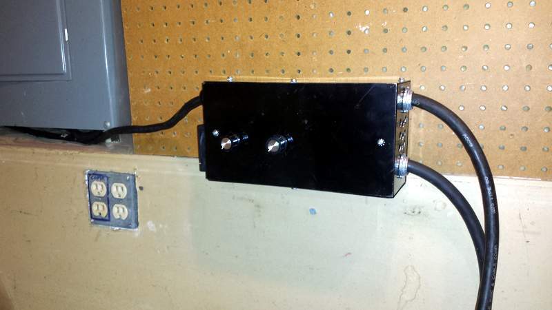

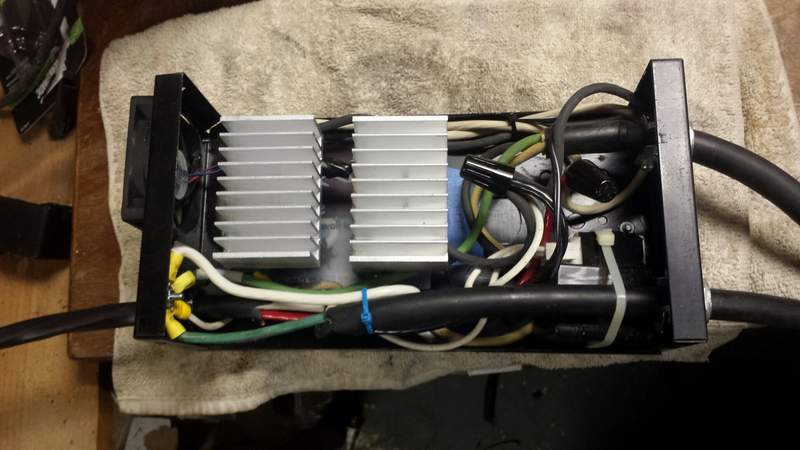

The controllers are 10,000W SCR's. 20 bucks ea on fleabay shipped from HongKong. http://www.ebay.com/itm/10000W-220v-Adj ... 2c7271bb5a" onclick="window.open(this.href);return false;" rel="nofollow They seem to work great, adjusting voltage from 0 to 240 as expected. The heatsink only got slightly warm across differnet power settings.
The box I mounted it all in was srounged out of the scrap bin at work. I mounted a 12V computer fan, powered by a simple wall wart power supply zip tied inside the box, The air is directed through the heatsink fins with exhaust holes drilled on the opposite side.
The elements will draw close to 30A each at full tilt, so power comes from a dedicated 60A breaker on 240V, via 8/3 wire to the box and 10/3 wire to each element. A female twist lock connector is on the hot side of each feed. The wire nuts that break out the mains into each controller are not your standard wire nuts. Those have a brass insert with threaded splice to tighten down all wires together with a screwdriver (like a bussbar), then the brass insert threads into the plastic wirenut shell. Very heavy duty.
