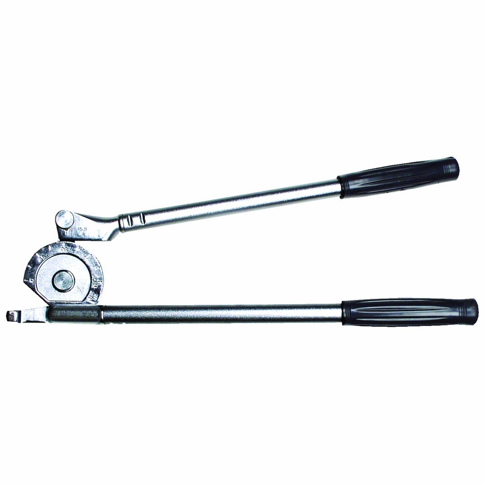

The issue with the hollow handled benders like your second picture is the handles bend over time. The solid metal handles hold up much better to stainless, especially 0.049" and thicker.

The legend on the package says it's for copper, aluminum and soft thinwall steel tubing. Probably need a $150usd + bender or a lucky find at a pawnshop. A bender that can do copper forever can get tore up in a hurry by stainless.
