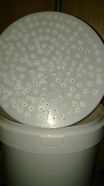

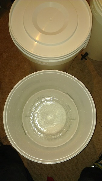

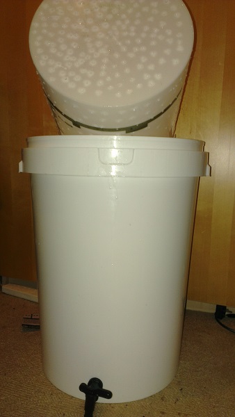

every thing has arrived.
so hears the pictures.
you could go for a symmetrical good to look at pattern but i thought fuck it and attacked it with my drill. should work the same ether way. going to fire it up tonight and get some all grain bourbon on the go.
will be moving to another thread for the recipe and steps. then come back and review how the hardware worked out. wish me luck

ive found that 7.5 kgs of grain after swelling fill the 25 liter tub so your better of trying to build a false bottom. fortunately the tub wont go to wasted just re-purposed for brewing beer.

after attempting to drain the barrel ive discover it trickles out at about 10min/l(probably not accurate but it wasn't good enough). so ive devised a back up plan where i use hose with many holes drilled in. 22mm x3/4"bsp female coupler. screw it on to the tap and go.

people are doing the same with copper pipe and elbows. they cut slits with a hack saw. nothing is soldered for easy cleaning. I believe jimbo has a thread about plus others. look in the still accessories threadsWooTeck wrote:after attempting to drain the barrel ive discover it trickles out at about 10min/l(probably not accurate but it wasn't good enough). so ive devised a back up plan where i use hose with many holes drilled in. 22mm x3/4"bsp female coupler. screw it on to the tap and go.
