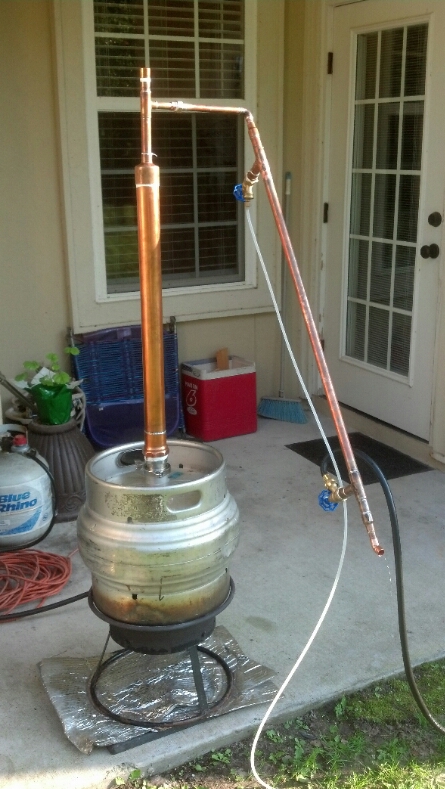

Deerhunter your confusion comes from a modular build being discussed that allows for a standard pot head still taking the place of the reflux coil. Mine has a 2 inch reducer to 1/2" over to a union then out and down to a standard liebig. Run your ujssm in boka with the valve wide open after allowing it to stack the foreshots and heads. And yes, I got 120 from the same mash on a pot with the boka running next to it drawing 160. Less volume but higher concentration of alcohol. The boka needs a small liebig on the discharge line to cool the distillant.
Ga Flatwoods
I am still kicking.
Ga Flatwoods

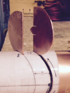

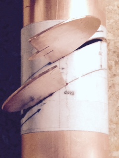

I think I will go with the 3/8" take-off. Here's where I stand, Just waiting to find the right solder to use.
