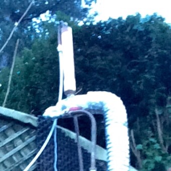

I have been fermenting in 25litre tubs, pot stripping runs at full heat on the kitchen stove collecting down to 10% ....averaging 37% low wines
First neutral spirit run, today it is snowing in Belfast Ireland
I have collected 40 litre low wines treated with washing soda and potassium permanganate to purify.
Boiling in 50'
The cooling water just needs a tad trickle to knock back the vapour on full boil. Maybe it's the snow. I've insulated the column but the coil is sheathed in bare copper gleaming in the morning sunshine. This is a beautiful day.
First discovery: get a needle valve on the water flow. 10mm nylon pipe and plastic needle valve cheap and effective.
Full reflux 1hr. Crack open the gate valve and run off methy fore shots.
After 300ml it sweetens up. Hovering around 89%abv
First litre into feints before I start collecting. That less dry slightly oily feel appears and woody smell is gone.
Big dilemma. I read here that hearts should be collected with the heat turned way down. That needs the gate valve near full open to collect at a trickle. Here's my dilemma, please help. With valve cracked open, liquid collects and gags the vapour flow. When half open I get a trickle but there's 2 or 3 oz collecting behind the valve. Surely that becomes LM and we no longer have a VM reflux column?
So I try running heat down, valve fully open. Flow settles to trickle, but uneven from drizzle to 3 drips/sec. Probably the wind effecting the gas. Now instead of LM or VM I seem to be running my still by heat management.
So what should I do to collect best hearts by VM? Low heat with valve open (is like a pot still plus condenser to strip out water). OR High heat (is like a bokakob LM)
My column- This head works both on my stove pot (condenser off for stripping runs)
And as here on top of the reflux column (with condenser for spirit run)
2" copper, 48" high reflux column on 45 litre SS keg heated outdoors by gas ring
Packed with SS scrubbers in copper mesh netting AND 3 internal reducing rings to help stream the reflux
2" column topped with rt angle bend into two pathways both 3/4" splits: up to condenser, and down to Liebig
Boiling in 50'

Not sure if I understand all of this but there shouldn't be any liquid collecting behind a VM valve. You reflux condenser should be over the column...that's the idea, sending the distillate back down the column. Seems to me in this setup liquid coming down off the RC is pooling behind your valve instead of going down the column. The only liquid you should be seeing on the output side is once vapor passes the valve and into the product condenser.

CCVM ala DAD300. No valve, no worries.
Got any better pics of that rig? I'm confused too.

The condenser should drip into that 2" horizontal. The vapour off take is horizontal thru a 2" to 3/4" reducer so the condensate cannot flow out but runs back down the column because the reducer is an inch up from the floor.
Wot de heck is ccvm dad300? Are u saying take the valve away?

Is this visible? My first uploads!

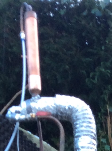

I took this from the drawings page posted here by I think it was hookline
Maybe I put the valve too late, should've been immediate on the horizontal takeoff and not after the bend. Just tried to keep it too tidy!
2" copper with bend into horizontal lyne arm. Two tees. First a vertical tee up into the condenser via 3/4" throat.
Next the horizontal takeoff thru a 3/4" reducer dropping down to collection.
Reflux vapours get thru packing and column rings travel up round the bend and separate better on the horizontal arm, water rising and ethanol falling (being more dense than steam)
Ethanol falls out to the Liebig while water mix gets knocked back as liquid and runs back round the bend.
At least that was his theory

I see what you are saying on the horizontal 2" reducer to 3/4". But somehow the vapor is getting cooled before the valve when it should only condense past the valve. Maybe others will weigh in. If I had to guess, the vapor path is longer than it should be ideally. Meaning, most VM's you put the valve as close to the column as is reasonable.
Edit: the other thought is that your valve is lower than the reducer. I'm not saying it should be higher, I'm saying if it was dead even with the reducer then distillate wouldn't pool behind it. Maybe. I haven't seen this design before.

Off-set heads are outdated. Few of the newer folks are going to be familiar with such a design. Part of the reason they are outdated is this: Inline designs such as a Boka or Dad's CCVM have the RC inline with the column to save money on the build without any loss in performance.
Your problem likely lies in its operation. You can find VM operations in the reading lounge. But I'll give you a tip... I would find out how much heat it takes to flood that column, then back off until the flooding becomes settled above or inside the packing. If you can keep the flooding just above the packing in a safe and controlled manner (stable) then it will perform much better. I call running in this fashion the sweet spot for my reflux still.
Turning the heat way down isn't doing you any favors. I can do this without a sight glass, but a beginner might consider adding one just above the packing to see what is going on.

I think u have it Sussed, Humbledore. When I ran this on stripping runs indoors the valve fully open no probs. today in the snow it is condensing before the valve. In fact my thermometer is telling 75/6 deg C at the takeoff, 4 deg under with cold air.
I will move the valve.
I haven't found nor heard of dads ccvm. What's RC? This in spite of 6 months research on this site trying to remember grad organic chemistry and learning wiped copper joints. And this was an experimental/ theoretical new design on Hooklines collection of drawings and ideas last year!
How should a VM spirit run be done when in hearts? Low heat valve open?

It depends on your system and what purity you are shooting for. Most folks run spirit runs with a little less heat. The amount of reflux you are getting is partly determined by the fact that your vapor exit is smaller than the still diameter. Then if you run it slower (valve part closed) you are forcing more reflux, thus higher purity. Some columns probably can get close to azeo wide open. Mine doesn't.
Re: VM spirit run, neutral
I edited my post above.
A RC is a reflux condenser.
High heat, valve open fully or removed completely. You don't need it in a VM. Run it slow until the fores and heads are removed without the valve, then put some serious heat to it. Just don't flood it, which can spell disaster.
I push as much heat as my LM can handle during a spirit run. More heat = more reflux = cleaner spirits = faster takeoff rates.

Ah! I see, and was hoping that the 1/3 sized exits was doing just that so thanks. So far, maybe until I move the valve, I can't get better than 90% no matter how I slow the flow. Same difference ooen or closed although the taste does seem to change, better slower.
Also, I will want whiskey when I know better what I am doing so 90% is good enough if not too clean. However, this is for vodka and gin, so to get my 95% I might have to dilute and run a third time?

So bear river I need to move remove the valve. How is the vapour then managed, as in VM?
Also, in this head I was thinking what is going on inside... If I push the flow I would push water vapour out too. Keeping it lower heat is less turbulence and the horizontal lets the vapours separate into two layers, light water and heavy ethanol??

So high heat, a stream of distillate running max output. I then depend on the design to separate ethanol from water and to reflux a) with theoretical plates, packing height and rings and b) condenser recycling mixed vapours c) drawing off heavier ethanol
I see. Neither heat nor vapor control. Just run her flat out as she is made.
Perhaps if I remove the valve and set the condenser arm nearer the vertical column and away from the takeoff outlet? Alter Hooklines design?

Casper, this is DAD's CCVM: http://homedistiller.org/forum/viewtopi ... d#p7104768
You lower the reflux coil into the vapor path to prevent any escape of vapor until the column has reached equilibrium. Fantastic design with no valve at all. You would have to be able to do this to remove your valve.
*Edit: I can't spell

Phew! Ta Humbledore, I was scratching my lower brain as I felt me losing my grasp on this run, opened valves, getting the fouling taste of tails, not a good product anymore. Then I realised, how can I get total reflux without a shutoff valve. And why try, CCVM looks more complex to craft, my coils are a bit rough yet a valve is only 5ukp or 7usd
Read kiwis tiller link with great interest, a good answer that empowers deeper understanding.
Screwed down the valve and foul tails gone, back to sweet quite excellent vodka.
What happens with VM when the ABV drops does the spirit slow but stay clean (unwatched) till it's not worth the propane? I am used to potstill where it keeps runnin thru tails till water. That's a lot of 40 or 50% pot ale to ditch, is that what happens on a VM spirit run?
I put a wee reservoir in my condenser, if I drill a 10mm hole there for an outlet I can convert to bokakob. Is that better to grab tails if I want whiskey or rum? Not sure what I could do with sugar tails except chuck it....
Too many q, sorry to jump around so much

That's encouraging ss, interested you say the architectural ratio is set by the constructed diameters, tweaked by valve (if fitted). My takeoff from 2" column is 3/4" so do I have a built in reflux ratio of about 2.5:1 ?
54/22 =2.45
The hookline column I built has the refluxer vertical but offset, although effectively on top of column and before the outtake. It has internal rings and wire mesh packing.
I also enjoyed and followed RADs design but in 2" copper, making it modular in height and incorporating a boka collar in below the coil. So it's VM but can become boka if I added a 10mm drain. However my first completed column was not this VM but a 3" SS bokakob and that's what I used for my first (and only so far) rum run.
Does the boka allow more control and deeper graded cuts than the VM? The boka needs constant attention as the ABV drops, each litre is different, flow stays high at steady low heat. The VM seems to deliver at constant 89% ABV with reducing flow before hitting tails pretty sharply, seems to need more heat input management
I have modified the outtake a little and will use the valve/ heat to try tweaking the next neutral run for higher ABV. If that gets no better than 90% am I tied to this architecture, need to think about a MkIII still head??
54/22 =2.45

There are probably tweaks you can do to that column. First how tall is it? Taller is better for purity. What kind of packing are you using? Some are better than others. Do you have a centering ring to return the distillate to the center of the column rather than it running down the side?

Yes I have two possibly three copper sections each with a centering ring at top end. 18" 36" and 12" modules, an unsoldered connector on each to slot them together.
I start with a short SS pipe with flange tri-clamped to keg, then slot in the 18" then 36" then head. Column height 60", could be 72". So with the reflux pipe added I already need a stepladder to reach and feel the top so 72" would put it not just out of reach but into full view of my neighbours in my city garden. I have learned not to trust nosey neighbours.
Currently using several dozen SS pot scrubbers packed into copper mesh which lets me remove easily for cleaning. I intended to buy more pure copper mesh to improve this, replace the scrubbers with rolled copper mesh.
This 2" copper column bends at the top into a lyne arm (also 2") which is also packed. No tee. After 12" there is a tee, with 22mm reducer up into refluxer. Then a horizontal reducer into 22mm takeoff.
I moved the takeoff ballvalve horizontal and tight to the lyne arm. I have extended the 22mm pipe after the valve immediately downwards for 12" it used to run horizontal 12" then down. This should let ethanol flow and seperate better.
The condenser rains distillates into the lyne arm, possibly cooling or stirring the flow of ethanol as it exits. That was Hooks design, I wondered if shifting it away would do anything. I imagine the design idea is to help condense water vapour at the exit so it should work there.
I am inexperienced in managing the run, maybe practice will improve the yield!

I agree that getting more experience running it could help make sure you're getting the best result. I routinely hit better than 90% and my column is 2" by 48" with an inline reflux condenser on top. Seems with that height column you'd get higher ABV. I don't think copper scrubbers will provide any more purity than SS, and if you've got a copper column you're probably fine. Not sure the packing in the horizontal portion is doing anything because there's no reflux going through it. I assume the reflux runs along the bottom of the horizontal section.
Another question, why would you have a a reducer into the reflux condenser? Was this a decision based on the cost of the fitting/T? I would think you'd want the full 2" right up to the reflux condenser. Not sure that impacts purity but just a question.
