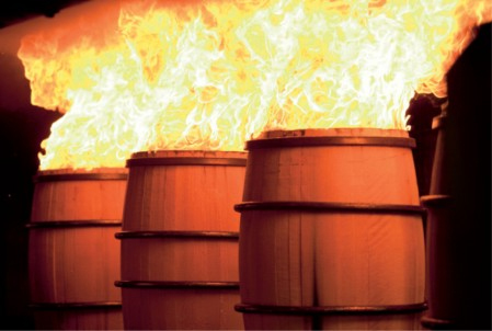

I received the OK from the Magazine to post this article. I didn't want to risk a knuckle rap for Copy-right issues. I found this very interesting and thought others would too.

It’s elemental, really; it’s something quite primitive. The reason for the barrel, originally, wouldn’t have been to “age” wine or spirits in the way we think of (indeed spirits didn’t come along until much later). Instead, barrels made things easier to transport. Sure, barrels were used to keep things in for a long time, from one harvest to another, say. But the idea that the character of the liquid inside happened to change — in a way that people found pleasing — is really a secondary, happy happenstance.
The character that a barrel gives a spirit (or a wine) begins with the oak that is used. American white oak tends to have a greater concentration of vanillins; the effect of French oak tends to be gentler, more subtle. The staves for the barrel first need to be seasoned; this means that they lay outdoors subject to the elements for anywhere from six months (for bourbon barrels) to two years for high-end French oak wine barrels.
Then man’s mastery over the elements comes into play. The cooper steams the staves into shape, guided by iron hoop rings. Then that oldest of forces, fire, is unleashed; it scorches the inside of the barrel killing off bacteria in the process. And, as nature would have it, the by-product of this is flavour. For wine barrels, this part is the toasting; for spirits, and bourbon in particular, this is when the char begins.
And there are many variables for the cooper and distiller to consider.
For one, there are different levels of char. They’re known, in the US as Char 1 through to 4. For whiskey barrels the American process is to char quickly at high temperatures. The barrels are placed over a gas burning flame from anywhere from 15 seconds for a light char (char 1), 30 seconds for a medium char (char 2), 45 seconds for char 3 and for char 4 (known as an alligator char for the leathered, cracked texture it attains) around 55 seconds.
Barrels destined for winemaking will often undergo a gentler process. A light toast will see only a slight change in colour of the wood, having spent around five minutes at a temperature between 120 — 180 degrees Celsius; a medium toast will see 10 minutes at around 200 degrees Celsius. A heavy toast goes longer still, with 15 minutes at 225 degrees Celsius.
But just which type of char a distillery employs varies on their house style. “We generally specify a number two char,” said Larry Kass of Heaven’s Hill distillery. “This is a bit inexact,” he said, “as a char level comes from the length of time the inside of the barrel is allowed to burn and will vary from cooperage to cooperage, from barrel lot to barrel lot, and sometimes from barrel to barrel.”
There are things to worry about with this level of char, he said. “The deeper char level has a tendency to leak,” said Kass, “especially the barrel heads, since it compromises the wood more when it is burned longer.”

The two photos are from the same article.
Thanks to Amy Spanton of "Australian Bartender" for allowing me to post this. Kiwi Bruce

Nice one Kiwi Bruce, thanks for posting. I wish that char level pic was higher resolution.

Your Wish! Double Click on the image, it should open to an 8" X 9" Pic ready to down load.Kiwi Bruce

I did not know, though #3 charing was alligator chared.

great post Kiwi, nice photos of the different chars too.
Some coopers will cap one end of a cask for the final phase of setting a char. Others don't char the caps while others still char the caps separate then set them when all is completed.
