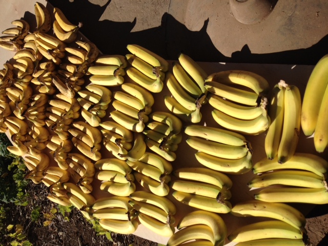

12 bananas, browned in the sun
5 cups sugar
1tbsp Soylent (a very nutrient-rich dietary thing that I eat for 2/3 of meals)
EC-1118 pitched at 71 degrees
OG: 1.058
FG: 1.002 (7.2%)

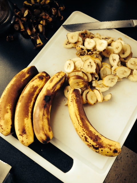

I didn't cook the bananas, or use the peels, I simply peeled them and ran them through the blender with some water.
I started this batch back on 10/2, and since it was only a 2-gallon batch I wasn't eager to waste a whole hydrometer flask of liquid, so I was judging it by taste. My wort refractometer arrived today, and I finally got a reading, and after adjusting it for the alcohol present, I finished up at 7.2%. I'd like to get something a *little* higher, but not much. I'm not going into this with huge expectations, I'm just hoping to finish up with some good banana booze.

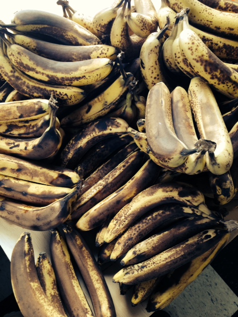

Today I went to Stop and Shop, and since the Produce Guy was stocking bananas, I asked what they do with the ones that had browned already -- he directed me to a back hallway of the store, where they have plastic bags of browned bananas for something like 10-15cents/pound, so I loaded up on enough for a 5-gallon ferment, which I'll start tonight. Not only do I not have to keep bringing them in and out of the house to get them to brown in the sunlight, they're cheaper than usual too. Win-win.

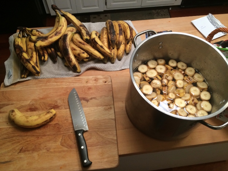

So, tomorrow's recipe will be:
1) Slice up the 32 bananas, with skins.
2) Bring them to a boil in a paint/strainer bag, then let them simmer for 30 minutes
3) Squeeze everything out of the strainer bag.
4) Melt 12.5 pounds of sugar in the hot mash
5) Cool it to ~75 degrees and pitch the WLP300
I'm not 100% certain of how much sugar I'm going to add, I'm thinking of target 1.070 for an OG, please speak up if you think you've got a better target for it. With the new refractometer, testing this stuff should be much, much easier.
Then it all gets topped up to 5 gallons in the bucket. I'm also adding a spigot to my 6.5-gallon Ale Pail, to make refractometer and taste tests easier.
