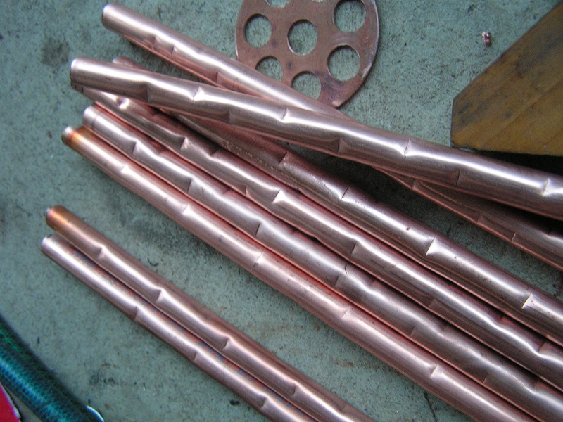

So I started on the PC . I wanted to braze the whole thing so I could safely solder on the connections without an internal melt down . I only have Mapp gas so to heat things up to red hot , I used a single ring gas burner as a pre heater and used the Mapp to bring to red hot where I needed it .

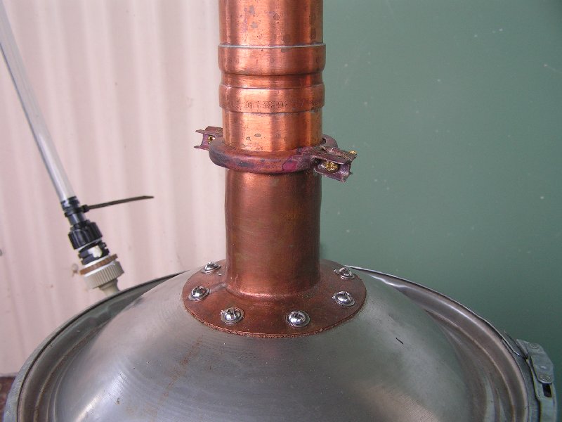

Next up was the Deflagmator . Then it was time to do flanges .... I hate bashing out flanges so I decided to just make up some 1/4" pipe rings , braze the ends together , flatten and braze on .

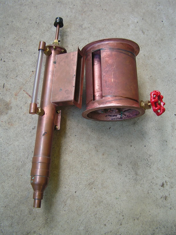

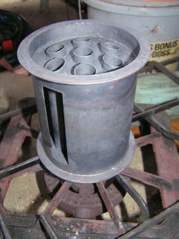

So you may be wondering why there is a huge hole in the side or the Deflagmator :think: ....well it was to the attach a cunning idea I had made previously . It was an adjustable water level thingy . I did not end up using it and haven't since but curiosity will get the better of me . The hole has a plate over it for now :wave:

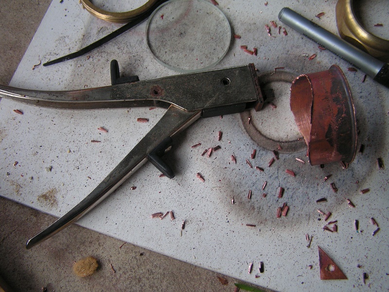

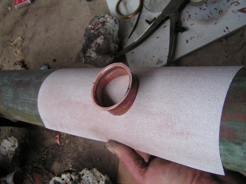

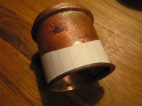

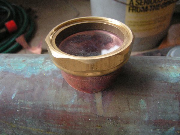

So I got out my 2" Cap and liners and looked at them .I was hoping to use them as is and somehow sandwich glass and gaskets in there but it just wouldn't fit and the copper pressings were to roughly stamped to allow a good seal so I basically ended up with some very expensive brass nuts .So I decided to custom make them to fit .I brazed a copper ring on the end of the liner and hacksawed off the excess . nibbled it close then sanded it to perfection .
I managed to find some 2" all thread so I cut off a few mm to act as a retainer thread

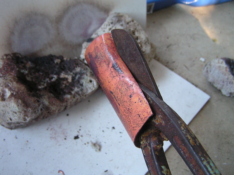

Incidentally , The standard 2" sightglass thats everywhere wouldn't fit these caps :wtf: so I had to make some . I thought long and hard about it but in the end used standard window glass . I know everone is now using Borosilicate glass but the first Flute builders used standard glass and I asked a few and they said they had not had any issues with it so .

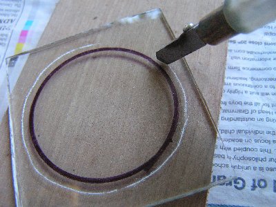

making sightglasses is bloody easy . You just have to have a very fine wheel on you bench grinder ...I later found keeping it wet helps too .
Mark the diameter , score it with a glass cutter ,rough it out with some pliers and finish it on the bench grinder

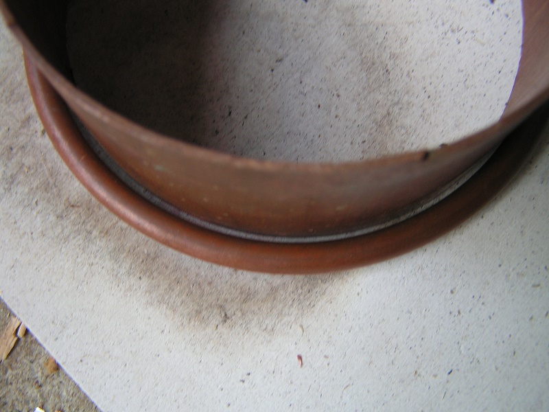

I brazed them on with the same Gas burner and Mapp technique. The worst part about brazing is filing off the flash that runs everywhere . I must have spent hours filing :twisted: .....What really annoyed me was I am well aware that if you paint liquid paper on your job just beyond the joint , the flash will stop and not go past it ......was just lazy and payed for it .

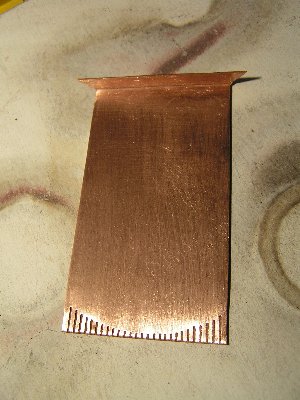

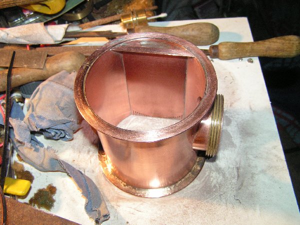

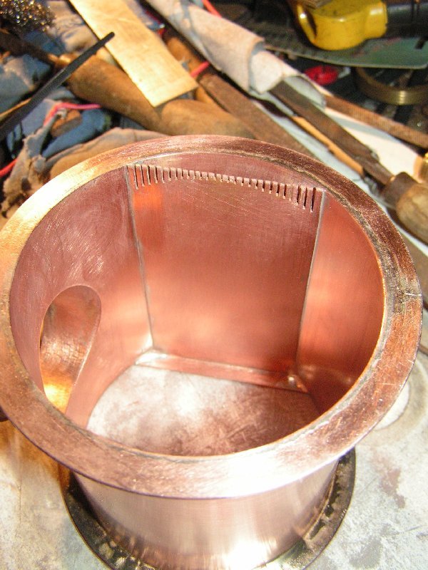

One thing that I really wanted to do was copy olddogs Mk11 weir down comers. There is just something about that classis design I love . and fortunately about the only thing I wanted to do from the start . So how do you fit them into a modular column :?: ...I thought long and hard . and eventually :idea: . Now this was a huge gamble and a shit ton of work .

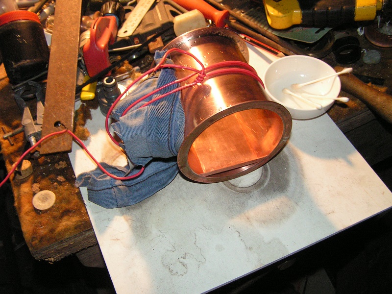

Soldering these in so the sight glasses wouldn't fall off was a night mere and I ended up stuffing wet rags in and around the sight glasses while I frigged about with these things. Finally I was seeing the resemblance of a Flute

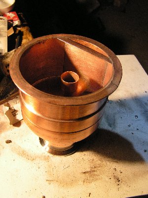

Then the bottom J trap section .This was an other custom job ...in hind sight I could have done a lot of things differently and easier :silent:

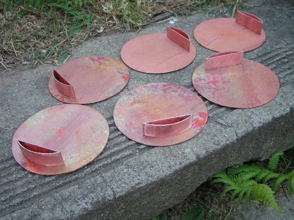

Then the plates . Finally decided on Perf plates .
So Anneal , cut , press flat , bash flat between two boards.
Made the weirs ...but not soldered on yet

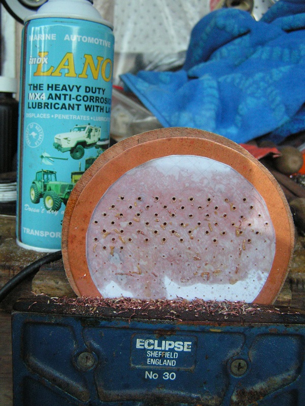

Then the ultimate question :lol: .....how may holes and how big :?: .......well after countless hours of reading and reading :crazy: I realized I could come to no logical conclusion .Every size and hole count possible had been tried and everone had there theory on idea hole size to plate size ratios and :crazy: :crazy: :crazy: :crazy: .
So in the end I went for 1/6" on a 1/4" grid :lol: ......and I followed Salt bush bills suggestion of using Lanolin spray and not a single drill bit was destroyed in the making of the plates :clap:
Posts: 10557
Re: Yummyrums Flute build
Counter sunk the bottom of the holes . Had to de-burr them anyway so as I had a counter sinking tool it was just as easy to wizz it into every hole .

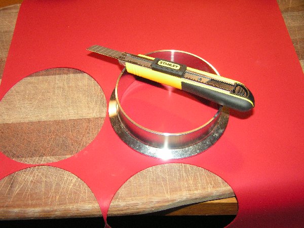

Cut out the gaskets ...and this is my choice ...others will not agree , I am sorry , use what ever method you prefer . Cut them out of copper sheet and wrap them in teflon tape . :thumbup:

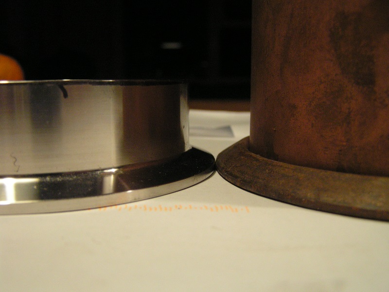

To get a good flat seal I had to grind the flanges ( and those with down comers attached ) perfectly flat ... The best I could do was "lanish" them by using the flat concrete floor of my garage . I swear it sound really dodgy but flat concrete makes an excellent grinder for copper :D

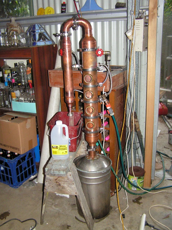

So finally it was all set up for a vinegar run...the moment of truth .... would all those layers of plates and gaskets and flanges all seal :think: ...would the home made sight glasses crack and liquid ethanol pour out by the gallon :think: , would the sight glasses even seal ....and we wont disclose the gaskets used here :silent: ...suffice to say may use the same .
So As I fired it up on my 2400 watt electric element ( which only runs at about 2200 wats due to the number of extention cords that run out to the shed )......but that's anther story :moresarcasm:
So the run did work better than I had expected . One sight glass did leak so I tightened it up....then the bloody glass cracked . But to my surprise , no liquid came gushing out every where which gave me confidence that should this happen on gas that it would not be as bad as I had imagined . :thumbup:

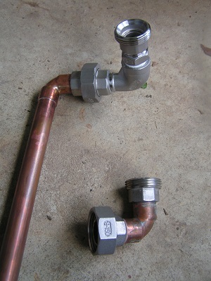

Being scared of highly combustible liquid and gas burners I made a longer take off pipe which joints to the PC via a SS union .I tried soldering the unions onto copper pipe elbows and it was a nightmare so just bought the elbows in SS :D
So now its easy to setup take off pipe

Thanks Swede ...Hmm the gaskets ...really didn't want to go there but I wanted it to be true to there it is . But it was an experimental design and all I wanted to do was prove that it would work so that's why I used it. I am re-thinking the down comer idea and may make it combined with the plate as a one piece plate . That will make the gaskets much easier to make ( just round not as they are at present ) . The copper wrapped in teflon is a good idea but would be a PITA to make .
It is the weak point . :thumbdown:

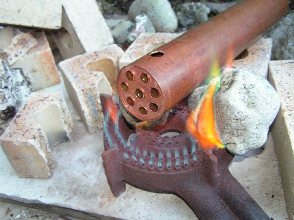

You got to get it red hot to melt the brazing rods . An oxy acetalene set will do it but they are not very DIY available .
You can forget Butane gas torches , they just can't get hot enough ...even for a tiny piece of copper.
Mapp gas will get most small to medium ( up to about 2" copper) hot enough to braze . Its all about getting enough heat in while it dissipates into the air . If you try to braze the end of a 1 meter long piece of 2" , you will be there all day and use a can of gas before it gets hot enough .
So as you might have seen , the trick is to stick in extra heat from a gas burner that overcomes the heat lost while using your Mapp torch to bring the area you want to braze up to red hot . Brazing copper to copper is really easy in that you don't need ant flux . The rods are available in 2,5 and 15% silver content typically . It's used by plumbers and they call it silphos in some countries . I buy mine at my local Bunnings hardware .

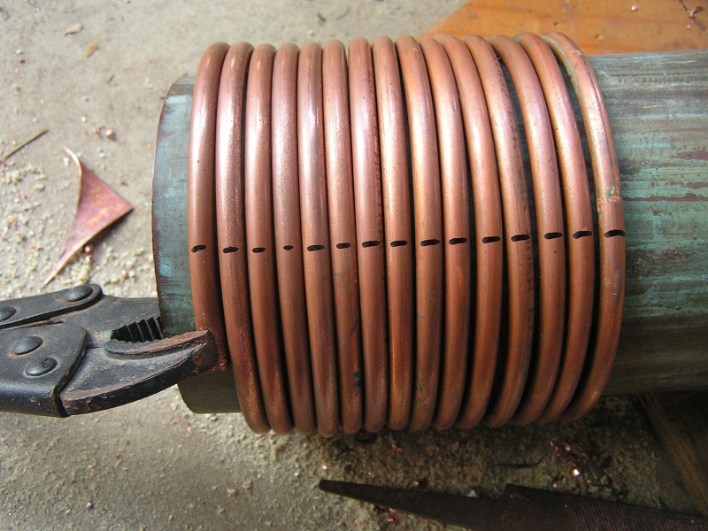

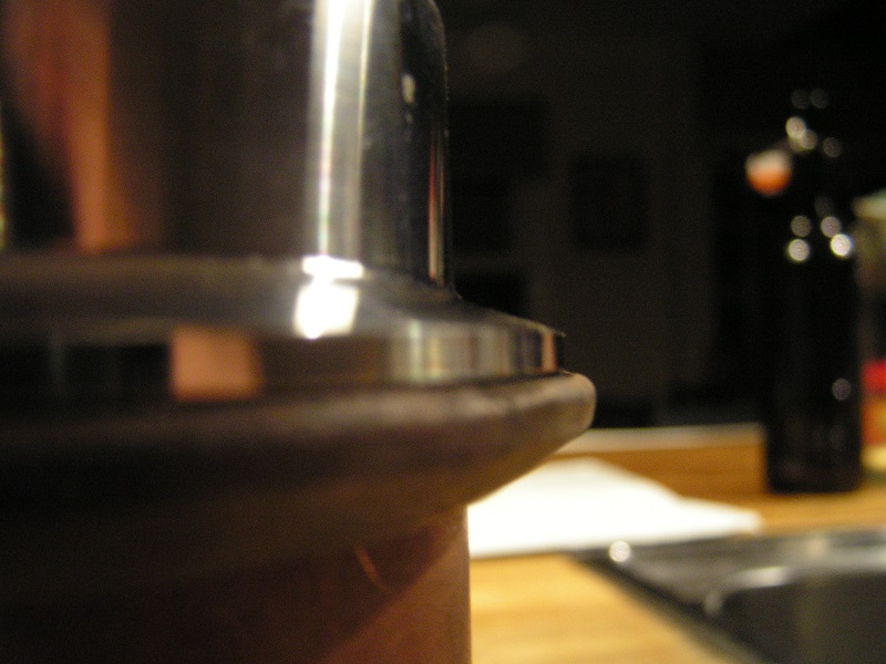

The only thing issue I had when brazing the rings on was quite interesting actually . You see I must have got a perfect end to end seal on the 1/4" so when I flattened it , it compressed the air inside . When I went to braze it to the 4" I must have held the torch in the one spot to long . The copper annealed ( softened ...as it does when it gets red hot ) and a bulge appeared .Fortunately I hadn't touched the rod on it or would have been stuffed .I ended up drilling a 1mm hole in it to let the air out . In fact i pre-drilled all my rings after that but in hindsight I think I just applied too much heat in one area for too long

Yak . was thinking about my answer to you earlier and I may have given you a dodgy answer :oops: . I am in Australia ...our copper is OD ( Measured Out side diameter ) where as ...and I'm guessing you are probably in the states . Your copper is measured in ID ( inside or internal diameter ) .
So your pipe is fatter than ours . it also depends on the type of pipe you get . some is thin , the DWV type used for storm water and drains ( which incidentally I used and its perfectly fine ) ..or the heavier guage stuff designed for high pressure mains water supplies . Then there is the ID/OD difference in the 1/4" stuff .
So ...I can understand why you questioned me about grinding it down to fit . You are absolutely right . Whereas my Aussie stuff worked out perfect diameter when flattened , your US stuff will surely be larger than a standard Tri-clamp ferrule .
Incidentally before I ended doing what I did , I tried to make an ( angled ) ferrule out of our Aussie 3/8" stuff to try to simulate a real tri-clamp profile but it always lost shape and flattened . Eventually I found by painfully filling the tube with fine beach sand before brazing the end closed I could get the wedge shape I was after as the sand inside stopped it collapsing .
Unfortunately it was just too large even though I was getting close with the profile . I figured that perhaps 5/16" would be the go but it was prohibitively expensive here as its only available to Aircon companies.
So there's no way US 3/8" will work its larger than ours and then you have to fit it to a larger pipe
So it may well be that with your US 1/4" you can fashion a more wedge like profile . Keeping it a wedge will certainly be better in terms of how a tri-clamp works .But remmber that a standard triclamp gaskit is only about 2mm thick so this will effect how you insert your plates and gaskets .
My method works but like most "easy flange" methods , it is a bastardization of the tri-clamp system Mine just happened to work be cause the thickness of the flanges , thickness off the plate and the thickness of the two sandwiched gaskets just happened to be the perfect thickness that it lined up with the tapered sides of the Tri-clamp .
It is not uncommon for flute builders who have made there own flanges to spend a lot of time mucking about with gasket thicknesses to take up or reduce the size so it all clamps up nicely

Had some PMs and requests for further info so Yak and others that are interested . Here is a step by step on how I made the Brazed on Flanges ..... Here
