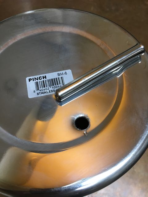

The body of the barrel is an inexpensive stainless steel bain-marie insert from Amazon. These are 6-qt sizes, $15 each. The wood is white oak, about $4 worth each. The spigots are either stainless steel ($11) or wood ($5-$10)

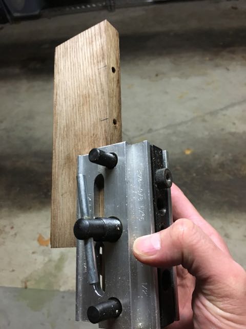

Make three or four pencil marks for doweling. Get out your self-centering doweling jig (Harbor Freight, $15) and drill holes for those dowels.

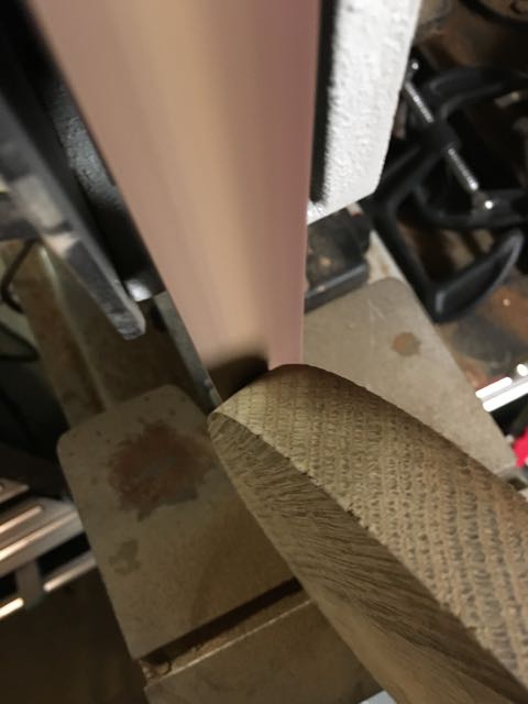

Cut the round barrel head slightly too large. This leaves room to refine the roundness and also put a little bit of bevel on the edge. The bevel is useful because the bain marie inserts are very slightly tapered. You want to maximize the contact between the barrel head and the can. I use a belt sander to round and shape the edge of the barrel head, dry-fitting it in the can often as I go along.
Drill a hole for the tap and a hole for the top bung plug thing.
To get rid of marks, unevenness, dirt, whatever, I throw it through a planer.

Set the charred barrel head in the insert with the tap in place. (Edit: the stainless steel tap comes with two gaskets, two washers, and a nut. You don't need those. Throw them away. The wood will seal up against the threads of the tap just fine) Fill it up and over the top with water, upright, for a day or two. After that time, top it up and jam the peg in the top hole. Place the BBOB on its side and wait to see what it shows you. :) After an hour:

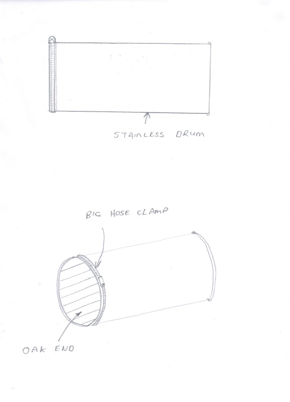

Posts: 10569
Badmotivator wrote: Three stainless steel nails through the side and into the wood should fix the head in place.
Good thinking 99. Badmo that is an excellent write up and tute . :thumbup: ...and I can honestly say that because I had a similar idea but couldn't come up with a working solution . :cry: I love your doweled sections and the final solution of using Staino nails to hold the wooden end in .
I'm keen to see if it works for you . I also believe ( but its just my opinion ) that this method should work and not cause over oaking issues some claim due to the smaller Oak area to volume ratio . Some have tried an Oak lid on a glass or staino container in an attempt to seal but use the wood as a vent to the angels but I "feel" that the wet on one side , air on the other method is more inline with how a barrel works :think:
Heres the link to my idea .
Here's the diagram for those that can't see it in the link
