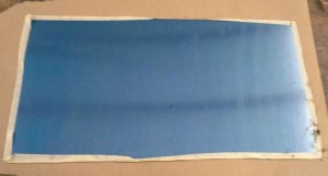

As luck would have it I have been working on a new vent hood for my kitchen and received some .032 stainless steel for this project. I needed to make a cutout for the fan insert which left me this nice chunk of SS to work with. I figured this was just about the perfect thing to make the new picker from.

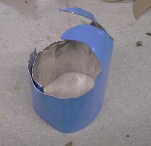

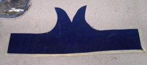

So I made a paper template Then cut one out of aluminum tape which I used for a prototype Once satisfied with that I cut it out of SS

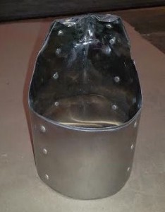

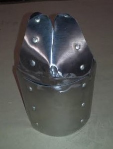

y next task was to roll the SS into a tube and make the hook on top and rivet it all together. After that I thought the hook was a little too flexible so I reinforced it with some of the scrap pieces, then added a reinforcing piece below the hooks so it won't need a mid season repair. The final result is this.
It looks a bit more like a part from a suit of armor than an apple picker so I am calling it the apple gauntlet

Do the "ears" go over or under the apple being picked? Trying to get my head round the orientation...cranky wrote:It looks a bit more like a part from a suit of armor than an apple picker so I am calling it the apple gauntlet

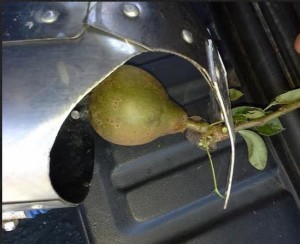

The ears go over the apple with the stem poking through the V so when you pull it pulls the apple at the stem and it drops into the net.Mikey-moo wrote:Do the "ears" go over or under the apple being picked? Trying to get my head round the orientation...cranky wrote:It looks a bit more like a part from a suit of armor than an apple picker so I am calling it the apple gauntlet
I tried to get a picture to illustrate it today. I did have to extend the ears out a bit because with the basket mounted vertical instead of sideways it is very difficult to see when you have the apple where it should be. The langer ears help in guiding and give it more area to get the stem into the V.
