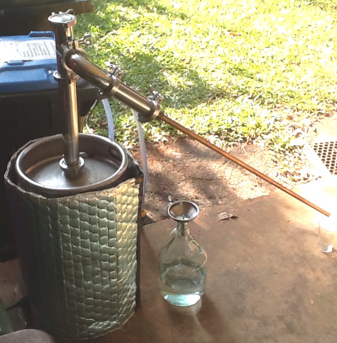

I never forgave my elder brother for taking his Meccano toy construction set with him when he left home to get married. Anyway now I have my own construction set to play around with!
blurry pic sorry, had to stand on a stool to get this photo.
I love the convenience of modular configurations for ease of cleaning and packing up.
cheers!

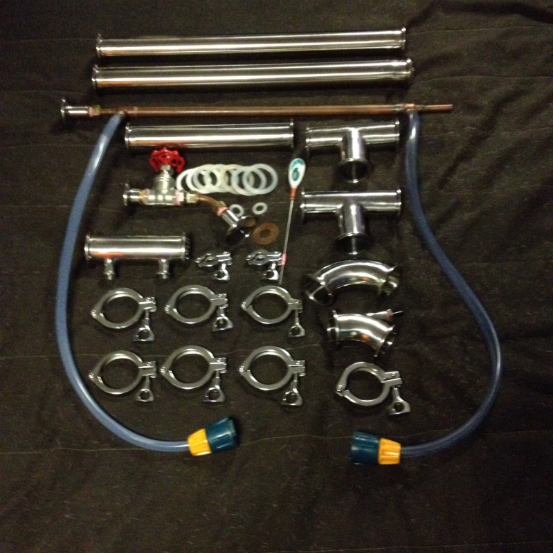

Modular 2" Pot Still
kimbodious
Posts: 1223
Re: Adult's Meccano Set
Post by kimbodious »
The gate valve is 3/4". The long sections are 600mm long. The copper disc is a centering ring for between the two 600mm packed sections. The tee below the takeoff is where a sight glass is planned to go(?). The RC is a SD Big Baby condenser. Sing out if you want to know anything else.

Well,well,well...I think your brother gets seriously jealous when he sees your new toy.. 8)
It's a 2" column, I assume..?
Have you thought about using a pump and reservoir for the cooling..?
If so, a "bypass" valve to the RC will be a good idea.
It will enable you to run full flow through your Liebig and control the amount of cooling water to the RC..

Is your reflux condenser a 10"-12" shotgun (dephlag)? Are you mounting that above the vapor takeoff Tee? Try putting it below the Tee and make it a CM.
Good looking equipment...a lot of potential there.

Thanks for your comments. Yes it is 2" and quite adaptable for suiting the suggestion you have made. That is the beauty of a modular set up and worth the extra expense. I am considering involving an inground swimming pool as my supply for the coolant, only problem is that is is 19 metres away from where I set up my still.
Yes it is the Still Dragon Big Baby 2" shotgun condenser, I would think it is more like 6-8" long.

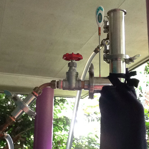

You use that as pot still with that valve and you want to be damn careful, you ever accidently have that valve turned and you got a very dangerous bomb there

thecroweater wrote:You use that as pot still with that valve and you want to be damn careful, you ever accidently have that valve turned and you got a very dangerous bomb there
+1 Crow ......You have to have your wits about you when setting this sort of gear up . ...Definitely not for the novice .
Kim in his parts layout for the Pot set up left the Valve to the side ...thank fuck ....you would be a dick if you included it .

I was being all artsy with the pics of bits and the stills. It distracts from what I really wanted to show. I'll see what pics I have on this device that I can post here.

Pot still run. Not a fast strip this time. Today's run is a double-distillation for slowly collection final spirit from the All Bran Low Wines. There are no components left from my original pot still (except for boiler and controller). The chunky piece of stainless steel on the diagonal with the two clear hoses is a StillDragon Big Baby shotgun condenser that I also use on the tall still. In fact all but one component you see here is used in the tall still. The idea has been for a completely modular system with the minimal number of components to configure to the type of still required for the job.

Post by Danespirit »
It's looking great...! :thumbup:
I like the way you managed to get a weight balance with that dephlegmator as a product condenser.
For my first pot setup, I also used a piece of copper pipe as an extension.
It's a good way to get some copper in your product path and also add some extra cooling.
Your stills are a perfect example of how versatile a modular setup is.
What's the collection rate on your setup...?
