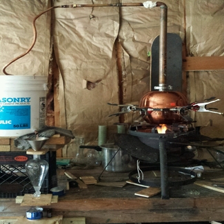

Made peppermint essential oils today. Very exciting stuff! :D It was my first attempt at making essential oils. I made a small rig for under 30 dollars and a little scrap copper I had around the shop (not counting the separator I bought almost year ago *cheap from china,decent quality*). Here's what she looks like.
I made my paste gasket and clamped my bowls together tightly. I attached the loaded column via tri clamp and put the heat to her while I attached the worm bucket and filled with water.
Once she got hot I checked for leaks and watched til she started producing. I'd say the first 25 mins the liquid was clearish (should have taken a picture at this phase, apologies) and I swear I turned my back around and grabbed something and when I looked back it turned urine colored. Surprised the old lady and I. I knew it was supposed to be something other than clear but it took some time before it turned and I'd be lying if I said I wasn't nervous til I saw the color change.

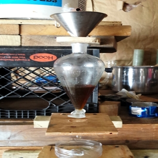

After awhile I noticed the drip that ran into the separator was beading a lot darker than before, almost reddish brownish color. At first when I'd put a flashlight on it even though it looked dark, the light would reveal golden goodness. But eventually it went dark even with the light on it. I believe the culprit of this is chlorophyll. The oil smelt fine and I still had plenty of water in the boiler so I let her ride. Looked like this,
I got nervous about running out of water so I shutdown after another 500ML or so. I collected what you see below. They are in order of collection.
(Note* After shutdown I ended up having about 450 ML of dark water/oil left in the boiler, so I probably could have let her go a while longer....if the dark color is okay that is)
(If color change is a good thing) Did it take so long to turn color because I packed the column to tight or was I not driving enough steam through the plant material?
Does any of this oil look okay to use?
Did I do anything wrong or could I have done something differently to improve?
All criticism, good or bad is appreciated as always,
Rain

Can you give a little more detail about your process, did you use water or alcohol? how much peppermint did you use? how did you prepare the peppermint? Where did you get your peppermint? Anything else you want to add!
PS: next time could you make your pictures a little larger, us old folks just don't see as well as we used to.

I used water. I did not know using ethanol was an option. Is it the preferred method?
I did nothing to prepare it. I simply opened the packaged and poured and packed the column. (Used copper mesh on both ends to hold in the herbs)
I used roughly 150-180 grams of the out of the bag of peppermint.
The supplier I bought the 1LB bag of peppermint from Holistic Herbal Solutions LLC based out of Ohio USA (http://www.holisherbs.com" onclick="window.open(this.href);return false;" rel="nofollow) .says Peppermint Leaf C/S Mentha piperita on label under the company name. Solid black airtight ziplock bag to reduce sun.
The old lady is getting accustomed to using the oils so I need to figure this out and do a lavender batch as soon as I get a better understanding of what I'm doing. :crazy:

How are you separating the oil from the water as with the still your using those look like large collections?

Bushman wrote:How are you separating the oil from the water as with the still your using those look like large collections?
The glass oil seperator. I thought it looked like a lot. So is it not separated yet? I was hoping the goldish stuff was the hydrosol and the dark was the oil but like I said I thought it seemed like a lot of oil.

Rain distiller, I use a syringe to separate the oil most of the oil floats to the top on some types it sinks to the bottom your mint is a bit dark but most the time you can see the oil.

Bushman wrote:Rain distiller, I use a syringe to separate the oil most of the oil floats to the top on some types it sinks to the bottom your mint is a bit dark but most the time you can see the oil.
What caused it to be so dark? bad material? ran too hot?
Posts: 18580
Re: Making Essential Oils
Not sure as I have never done mint but I grow it so when the time to pick it is right I will do a run so we can compare.
I don't really know what's going on, I mean, it looks like a lot of puking? The video below shows the stream distillation of herbs. It's glass (let's ignore that for a minute - but these are designed stills for this purpose, no alcohol) so you can see what is eventually in her boiler is what looks like what is in your bottles.
18 minutes, but it definitly put proportions into place

I would also guess puking. That is a good video, nice having that separater. The glass container with the small opening would be difficult to clean after the process.

Bushman wrote:I would also guess puking. That is a good video, nice having that separater. The glass container with the small opening would be difficult to clean after the process.
Eh, Rubbing alcohol and good h2o rinses and it'll be brand new. I guess the small baby bottle cleaners with a little rubbing alcohol for the narrow neck, if there was a buildup of some stubborn leftovers after initial flush that is.
