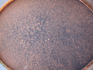

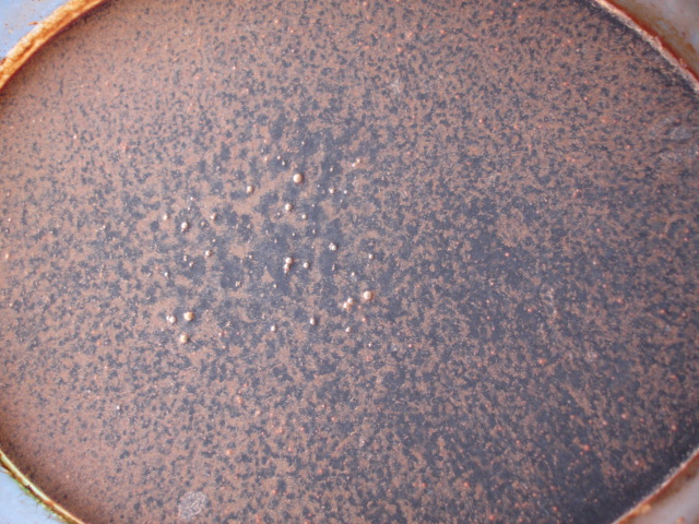

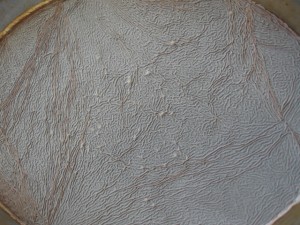

Development of the two dunder pits:
The first bucket (the dirty one with old Malt Whisky backset) had developed within 2 days a pellicle, the second with the yoghurt starter needed 2 days longer. Unfortunately both infections died after a week (or slowed down?). I tried to add a bit sugar and to add a bit more calcium carb. Didn't help. Unfortunately I had no pH-meter, only pH-strips, and they don't work with such a dark liquid. So I decided to buy online a cheap pH-meter. Unfortunately shipping needed a while, so I lost two more weeks.
The measured pH was 4.6. Low but not too low. I rised it to 5.5 with calcium hydroxide, it didn't help. So I realized the problem was the high gravity. I decided to dilute it more: To 8l backset I poured 10l water. This solved the problem, the infection started again. And because of the current high temperature in my region it grew very fast.
Here current pics of the two dunder pits: I am very happy that they look very different. So perhaps they taste different and I can learn something from the experiment.
