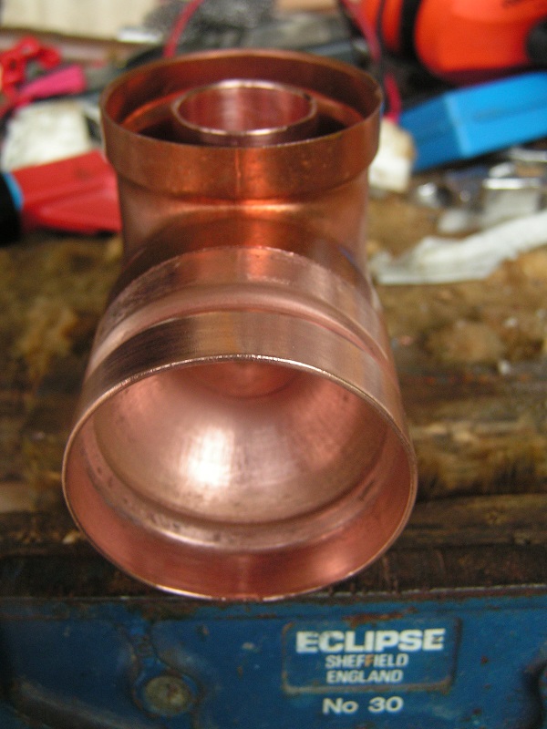

Here's whats inside it .
It was a bitch to make.

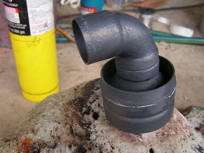

I had to chop up a few fittings so that they would fit concentrically...no biggy but had to be done .
I Brazed the 2"-1" reducer to the 1" 90 bend so at least that wouldn't fall apart when I soft soldered the rest
Cleaned it all up ready to soft solder the copper bits .
Soldered on the Staino Tri-clamp ferrules and the thump pipe

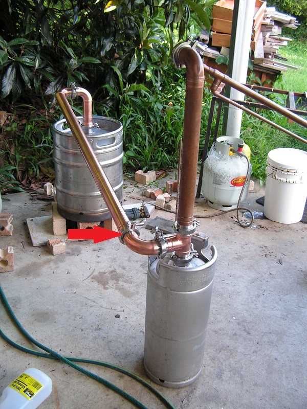

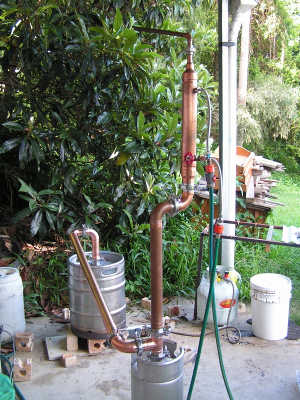

I realized that my initial design was ideal in theory but in reality no two kegs will stand up perfectly vertical and the addition of my homemade couplings would throw that further out .....so I added another tri-clamp in the feed pipe to aid alignment .So now it doesn't matter how wonky my kegs sit , I can still join them together with no stress on the joints

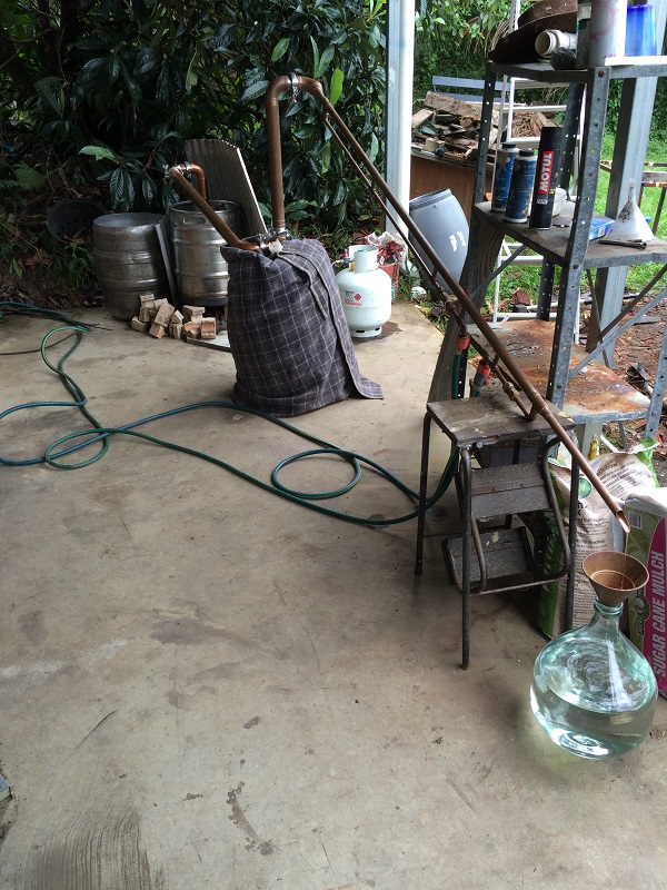

Here was my vinegar run Here I was using it as a steam stripper . That's an 80 liter keg under the blanket
With a Shotty.....Vinegar into the bucket
Here's soldering the ferrule and 90 deg onto the connecting pipe .

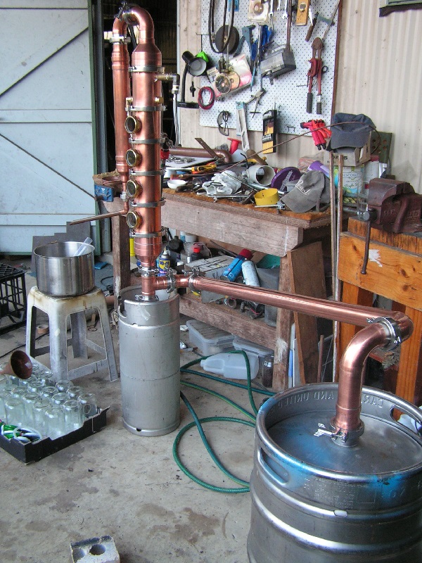

Can use the short coupling as a thumper fill port
Can hold thumper in Full reflux
Can stick a flute on it too .
Change the angle of the dangle if I want .
And does this make my booze the best in town ?..........not really ....but I have fun

I only have 2400 Watts of electric available and I do most of my distilling over a gas flame but it freaks me out . My main motivation for building this was so I could run my Stills but be a safe distance from the flames .
As you can see its very versatile but with that comes multiple combinations and I really haven't had the time to play with it all and find out whats best for what .
I have anecdotally found that steam stripping my rum wash was better than direct heat stripping but I need to try it more .
I did find that the thumper under the Flute was excellent at saving a low ABV wash .

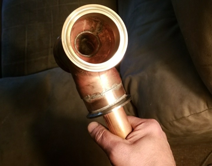

Re: Yummy's Thumper build

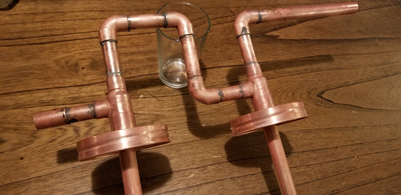

Thanks Yummy, I couldn't do it myself! Here's some more pics of it soldered(poorly) and test fit together:
And I'm one triclamp short of being complete
I still need to do a leak check and find all the leaks. You were right, it was a royal PITA to put together!!!And I'm one triclamp short of being complete
Leak check was so good I'm going to let it run as a cleaning run. Only 2 minor pinholes on connections, but none at the critical thumper connection!! It took about an hour and a half for anything to come out of the non-cooled condensor, but it's with only water. There was a tinny drumming as the thumper started to work and it came up to temp. One running it was silent. I drilled 12 holes in the bottom of the spear before starting.
After this I'll give it a soapy wash, a quick dip in citric, and then some cheap UJSSM for a sac run. Now I need to get some barrels

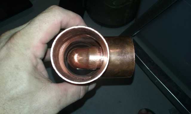

Howdy! I am building my own version of Yummy's Thumper build. The modular design is really inspiring.
There is one part that is stumping me, the 'T' where the vapor path goes into the thumper. I know there will be some cutting and some brazing involved. It looks to my eye that you are using a different kind of copper fittings than what is available to me in the US?
I'm wondering if anyone has built this using US copper type M, how they did it? Cheers!
3 x 2 x 2 tees are common. At least they used to be prior to plastic becoming so prolific.
Find a legit supply house. Wall thickness is a non issue.
Just gotta cut the stop out of the top side 2" part of the tee is all.

I used Australian copper fittings
I think beerswimmer used US fittings in his version .

I used a 2 inch copper sanitary tee from a scrap yard, a 2" to 3/4 inch reducer and a 3/4 inch elbow, all soldered inside the Tee.Caliche wrote:Howdy! I am building my own version of Yummy's Thumper build. The modular design is really inspiring.
Tummydoc- that is beautiful work. How in the heck did you solder it all? Was there brazing involved?
