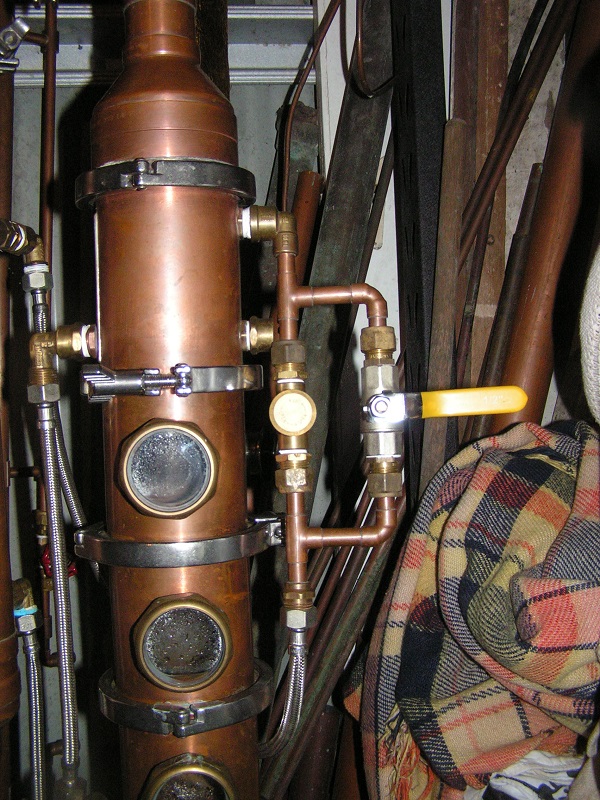

You should be able to find 1/2" needle valves no worries . Definitely forget using a Gate valve ...Ball valves are a nats dick better than a Gate valve but even though a Needle valve has around 5 full turns from open to closed you will hear that most including myself have it barely a 1/4 to 1/2 a turn from fully closed . Even with the benefit of multi turns and precision engineering you will find there is about a 1/64 of a turn between no output and more than you want .Big Stogie wrote:.... so a needle valve ? I was looking at gate valves and 3 way valves I would like to hardline this so I need to find a needle valve I have not seen one.
B.S.
Once you have found the critical setting on your needle valve ,its annoying when the phone rings and you want to put in full reflux while you aren't concentrating only to find afterwards that it takes another 15 minuates of shagging around to find the spot again . This is where many put a gate or ball valve across (or in parallel) with the needle valve so it can be quickly turned on or off to allow full reflux or quickly return to where you were taking off product again . A further refinement can be made by fitting a second gate or ball valve in series with the Needle ( and bypass Valve ) so that the flow to the RC can be quickly stopped ....this is useful if you want to run the Still in Pot still mode say for stripping off the tails after the hearts collection .
This is where a 3 way valve can be handy when used with a Needle valve as it can be configured to :
1 : stop all flow for Pot still mode
2 :route water through Needle valve for accurate product take off
3: Bypass the needle valve for Full Reflux
Here's my Needle valve with a Bypass valve for Full Reflux . I never Run my still in Pot mode so no second ball valve for me . Check out Salt Bush Bills Needle valve , his is a bit flasher than mine . You pays for what you get with them
Salt Bush Bills Old School Bubbler Build .....I just love the hardline cooling setup
Interestingly Salty's build used a " drop in RC " and he is also one of the few to run cool water in the top and warm out the bottom ...the way its technically ment to be done .Most of us just run cool in the bottom as it avoids air locks in the RC . That is why you will see a little air purging vent valve on the top near his cooling lines

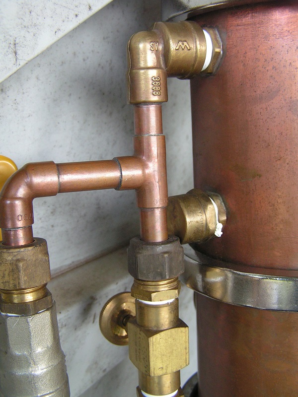

Hey Big Stogie . You see right . There are three ports on my RC . ...but one of them is capped . .Big Stogie wrote:Thanks Yummy, I like the bypass idea that is very smart. Looks like you have three lines going to the condenser? Have any pictures of the whole plumbing set up? Looking at Salt Bush Bills build and yours it is very evident that A. I need to rethink the cooling plumbing and B. I need a tube bender for that 1/2” copper
This is the back side pic of my plumbing . ( 1 meter packed column installed during photo )
Cool water enters the bottom of both condensers so that they are fully pressurized . The water exits via valves and combines before going back to my water tank . As mentioned , its not ideal to run the RC in reverse ...IE not counter flow but it works

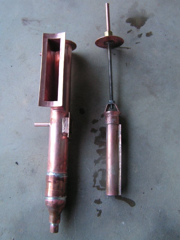

Incidentally , the reason I have the third port and the interesting strip of copper on the other side is because I was kinda where you are and was over reading and over thinking and before I'd even made my still I'd made a fan-dangled adjustable height Reflux condenser that was going to fix all the issues I'd read before I'd even build my still .
But in the mean time it has given me some real world experience and iff'n down the track I do try it , I will know how the basics work and whether all the extra bollocks was worth the bother .
So my advice to you would be to stick 1/2" BSP screw connectors on your RC and PC . Have a play with various setups . Flexible Braided hoses are great to use while you work out what setup works best for you ...then hardline your setup when you are happy .
