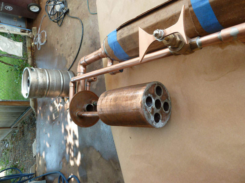

- Posts: 11549
Re: Avoiding air in the top of Dephlegmator
I've been plumbing the dephlemator with cold water in the bottom and hot out the top
Here's a pick of a 4" shotgun next to a 4" dimroth dephleg of similar knock down power.

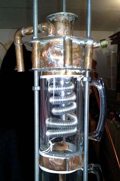

- cranky
- Posts: 6691
This is what mine looks like
It was much easier to make that a shotgun that's for sure
- Euphoria
- Posts: 487
- Joined: Mon Mar 30, 2015 6:48 am
- Location: Western WA
A Frankenphlegmator! Sorry, I just couldn't resist Cranky.
It's aliiiiiiive!!!!!
