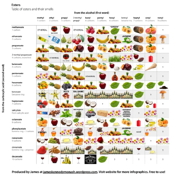

Damn, just lost a wordy reply, oh well, here's the short version
download/file.php?id=52466
Use the chart on this page to reference those official acid names with common ones, and chase links for microbes that produce said acids:
https://en.wikipedia.org/wiki/Carboxylic_acid" onclick="window.open(this.href);return false;" rel="nofollow
But in general, butyric, proprionic, and acetic acid producing bacteria make various fruity kind of esters, while lactic makes more sweet, creamy, caramel type flavors.
