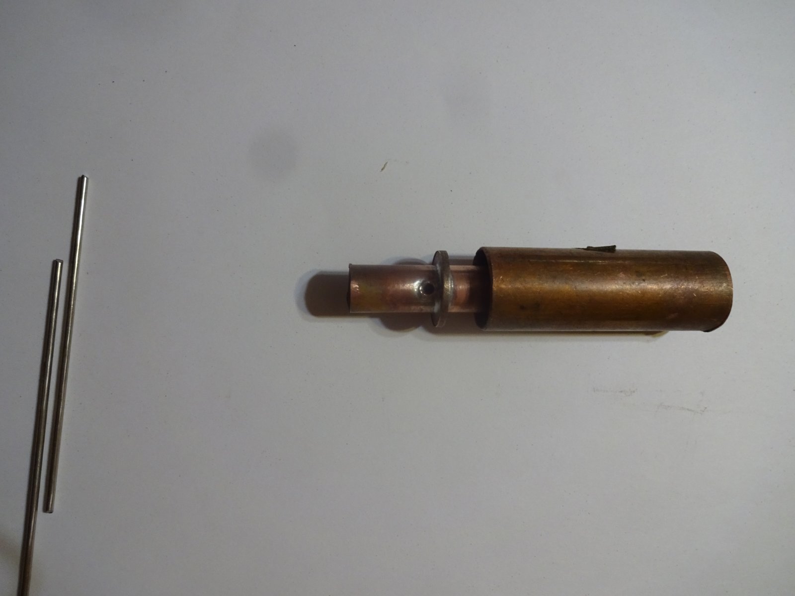

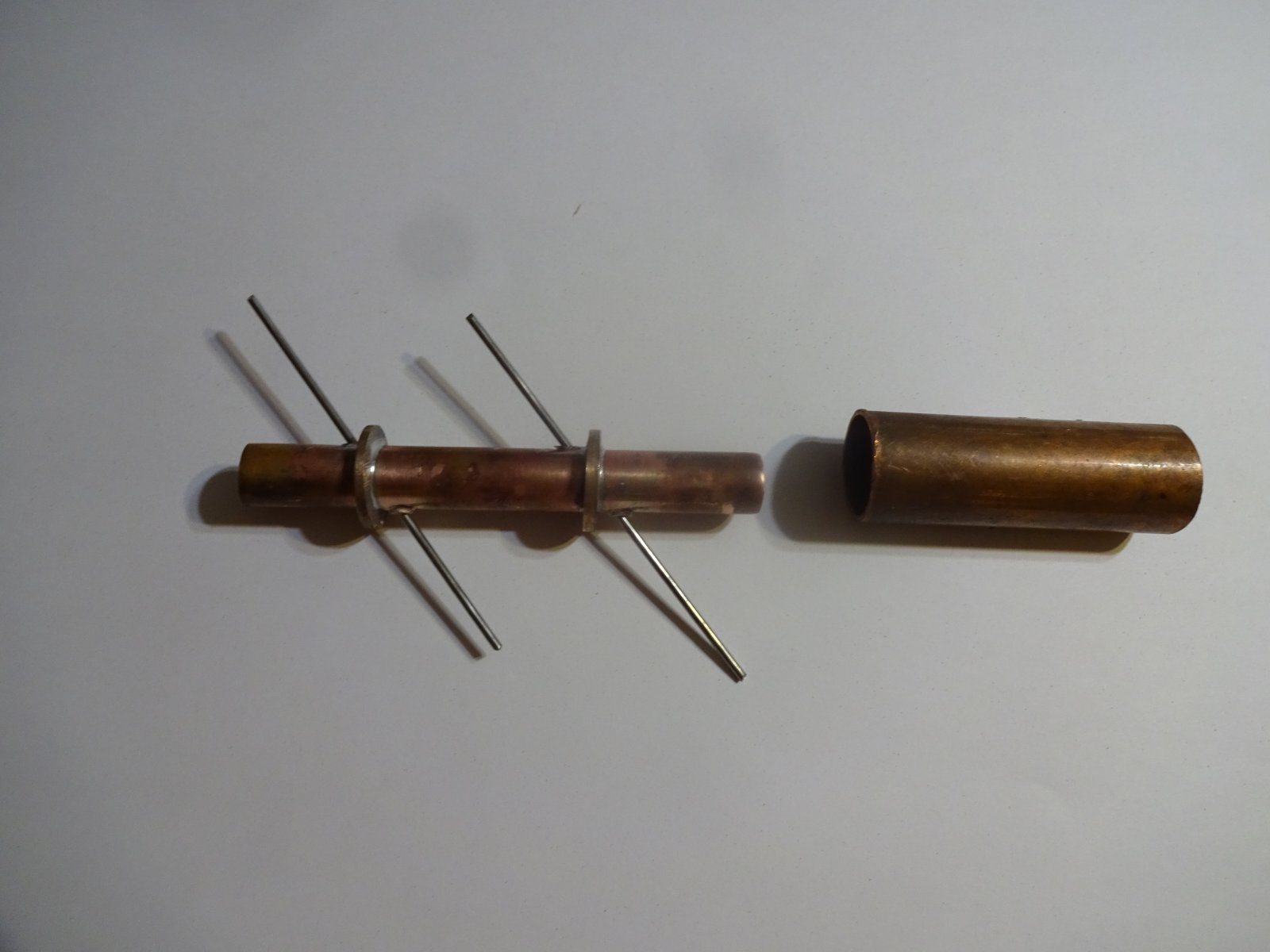

Well I know i always say keep it simple but I was tinkering at work and thought of building a new liebeg condenser that would be a bit more efficient and use less water to cool with during a run. This is a practice piece I came up with. Basically a 1/2 inch tube with rings attached to create separate water cavities and a cross flow tube to move water from one chamber to the next to create a gradual temp increase to the top. The cross tubes would also act to create a bit of turbulence in the tube as well as additional cooling surface to condense the vapor. This is only a test section I made with some scrap to see if I could do it . I will go to a bit larger cross tube when I make the full unit to test. Probably use 1/4 inch tube instead of 3/16 bu it was all I had in the scrap box. I will make the rings about .001 tight and freeze the inner section and heat the outer tube to make a slip fit then when everything comes to temperature they will be a sealed fit.Has anyone tried this and what do you think?

Awesome looking work. How long are you planning to make it? I can’t really answer anything from experience, but thinking about it here would be my concerns....
1) A typical Liebig using a wire wrap can be overly efficient if coolant flow is too high. I would wonder how hard regulating the coolant flow would be?
2) Having all the corners inside where the cross tubes travel through how difficult would it be to keep droplets from hanging up somewhere along the line causing a little extra smearing?
3) I don’t know how to exactly calculate the area of the 1/2” tube that will be taken up by cutting 1/4” out of the center. Seems it would either have quite a bit of velocity, or cause a choke point making the vapor collapse and causing huffing? A 1/2” circle has and area of 0.196”, a cross section of 1/4” that is 1/2” long, I realize it isn’t rectangle but for simplicity, is 0.125”. That only leaves 0.071 square inches for the vapor to travel past. A puke on grains could plug that off fairly easily, I would think?

The rings are similar to the baffles in a shotgun. And with the (well-aimed) crosstubes, the coolant is set up in a swirling motion around the jacket. Only thing is your prototype has a single vapor tube instead of a tube bank, like a shotgun has.
Again, the key design factors are 1) vapor velocity and the corresponding “dwell time” the vapor has in contact with the vapor tube walls, and 2) the surface area of the vapor tube(s) in contact with vapor and the coolant.
Looking at the mockup, I see that you will very likely have distinct zones where the temperature of the water will “step” up instead of a continuous gradient. This is because of the defined chambers between the rings hold more water than the crosstubes carry at any given moment. But the crosstubes will help carry heat back into the larger chambers, similar to the way a cold finger works.
An interesting concept, Corene. But it isn’t really more efficient, just different.

I love the way you think outside the box, Corene. You always get my vote when it comes to advanced design because of your understanding of metal (copper) properties and your superior building skills.
If I interpret your photos correctly, you have taken a tab out of the shotgun book and added baffles to retard the coolant inside the shell, with the intent of reducing laminar flow while collecting more heat prior to moving through a 'transfer tube' into the next baffled segment. With this design, I feel the coolant throughput between baffled segments would have to be significant, since the hot vapor velocity would remain constant (albeit slowed slightly by the added turbulence), but the heated coolant would begin to lose efficiency as the temperature variance between vapor and coolant starts to diminish. The coolant would conduct additional heat as it transferred through the vapor tube, increasing the difficulty in conducting heat.
I'm not an engineer, but I feel a shell and tube condenser relies on a temperature gradient the same way a worm does in a flake stand. Your design may alter this gradient, resulting in a net loss of efficiency.
An example of your design, without the baffles, is shown below. Because of the constant coolant flow, this condenser proved very efficient, but too difficult for the masses to build. Here is the thread.
Posted at the same time as still_stirrin...

Not quite for sure how long it will be ,probably a 42 inch chamber with the rings at 4 inch intervals. The cross tubes should increase cooling surface contact area for the condenser as well as cause a turbulence in the vapor flow. My thought on the turbulence would be to increase vapor contact time. On a smooth straight tube I believe the center of the vapor moving down the tube doesn't cool until it is very far down the tube itself. The turbulence should break this smooth flow up pushing the center of the flow towards the sides of the tube itself. I say this because the bigger diameter liebeg I built was not efficient at all. It was a 1-1/4 over 3/4 with a spiral wrap . It took a lot of water to make it work well. I picture the vapor going down the tube with the contact area condensing and slowing down while the center keeps moving down the tube working it's way to the outside of the tube until it finally condenses. I may build the first one with the 3/16th tube to keep the tube area larger. Or I could use a larger tube and ovalize it to make it have less frontal area but more contact area. My runs have always been cleared mashes or washes , no solids in the pot to cause a solid blockage of any sort.I have puked a couple of rum washes but it has only been liquid plus there is a pressure relief on the pot itself just in case. My thought came from the old cross tubes in the vapor columns in a pot still. These would cause a small amount of reflux in the column with out a reflux condenser. My thought of making it more efficient is in terms of water flow used to dissipate heat while condensing the same amount of product. As far as the temperature gradient goes I can see how the little cross tubes may mot have the same temperatures as the chambers but the water is constantly moving up and around so in time I think it would actually develop a gradient. In truth the best condenser I have ever used was my old Graham condenser on my original 8 gallon pot still. I could do a full 6 gallon charge and only use a few gallons of cooling water for the run. I have all the parts to make a new Graham with a 1/2 inch id by 10 foot coil. That would be very efficient and cool just about anything i threw at it. Like I said a long time ago, I am no scientist just a tinkerer and my mind tends to wander from time to time. Mostly learn from trial and error. Plus I haven't built anything in a long time.

Are you thinking of running vertical, or at an angle?
Most of my experiments only worked well at high flow rates because at low flow rates specific gravity took charge and I could feel the interface between hot and cold moving up and down the condensers almost the same as if there was nothing in the jacket.
With your design and method, there is little, to no, clearance for leakage between sections and I reckon it's worth a try.
