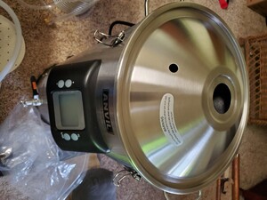

I recently bought an electric boiler (Anvil Foundry)and built a pot still. The stainless lid on the boiler has a 47mm opening and my pot still has a 2" standpipe. I am looking for ideas on the best way to attach the still to the lid. I need to be able to disassemble so I can make beer also.

Most people will not have any idea what an anvil foundry boiler is or looks like....a photo of the boiler and lid would help a lot.
I suspect it probably just another rebadged boiler the same as the rest......if so there will be an easy solution.

Saltbush Bill wrote: Tue May 26, 2020 2:00 pm Most people will not have any idea what an anvil foundry boiler is or looks like....a photo of the boiler and lid would help a lot.
Here is a picture. I think a T500 fits, at least it is an optional upgrade. The lid looks like it is 22 gauge stainless.

Looks very similar to a T500 lid , if it is there is an adapter that you can buy, a few of the still sellers on line where marketing them. Google should find them.
